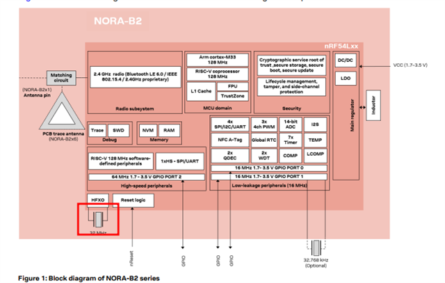

    2. Are you saying i need a physical crystal? or just that hfxo needs to be enabled.
    As for submodules i do have a bootloader folder that has mcuboot that came from either zephyr or west or the nrf download. I dont believe im using it (following the cli example which could be using it) so all my config stuff is in the main prj.conf, the zephyr.dts file looks like the clocks are all being set as expected
  • You need a physical crystal to be present. Otherwise you can't calibrate the LFRC as there is nothing to calibrate against. LFRC calibration requires HFXO.

  • sorry if im totally missing something here, doesnt this suggest that the internal xtal can be used for the hfxo? or can it not calibrate off that
