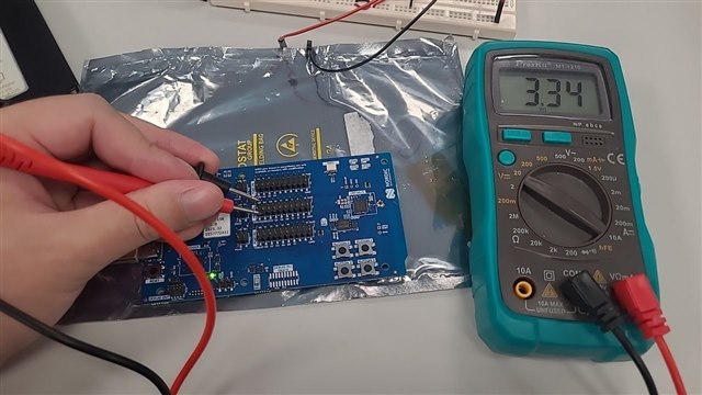

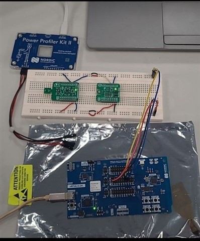

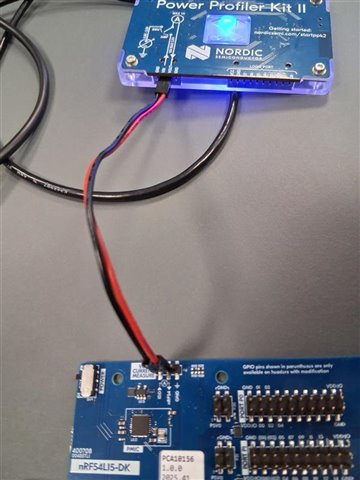

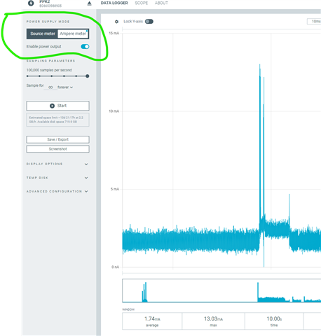

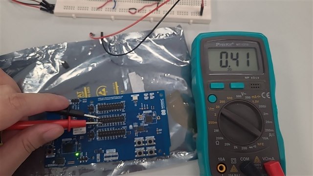

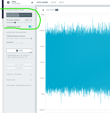

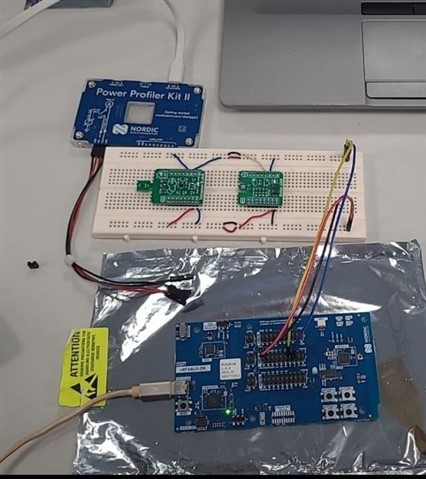

 i am asking for the configuration for  power profiler kit ii setup to the nrf54l15. The reason was when i removed the jumper from P6, the external sensors which were connected to the board went off. i thought something was faulty on the sensor board but realised that when i removed the jumper, the PORT 1 VDD:IO drop from 3.3V to 0.4V. So how am i going to measure using the power profiler kit ii with the sensors connected to the board?
With Jumper:                                                                                 Without Jumper:
Setup with Jumper:                               Setup without Jumper:
