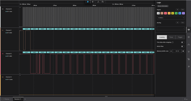

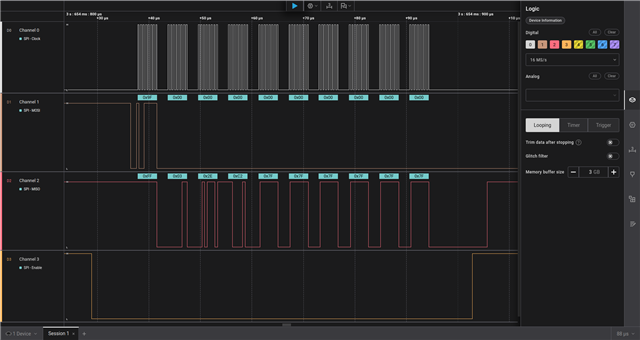

I have a project which need to integrate the FRAM CY15B108QN with nRF52840.
I got a weird result by using nRF silicone, but can communicate perfectly using other sillicone (ESP32).
(1)NCS Zephyr Result(2)ESP Result using RAK lib
(1) result when use zephyr; (2) result when use ESP32
Both sending 0x9F but having different response. The ESP32 result is matched with documentation, the zephyr one is not matched but consistently resulting the same value.
I've tried:
1. using SPI mode 0 and 3
2. vary the frequency
3. manually control the CS line
4. byte by byte transfer
5. using SPI 1 and SPI 3
6. using EEPROM SPI API by modify the fujitsu,mb85rsxx
7. raw simple SPI transaction
8. using SPI and SPIM
All have output the same result.
Appreciate your help.
Thanks
    Can you share application file so I can look at the overlay file, main.c file?
  • sure, please check this:
    I shared the board overlay and FRAM driver I used. I haven't reach the write and read memory, just read the RDID only in the init function for testing. Because if RDID still have issue, the other functionality may also not working properly.
    Do you have any idea whats going on?

    The result is aligned with the CY15B108QN documentation:
    I (339) main_task: Calling app_main()
    I (339) fram_rdid: CY15B108QN RDID test over VSPI
    I (339) fram_rdid: Pins: SCK=GPIO18 MISO=GPIO19 MOSI=GPIO23 CS=GPIO5
    I (349) fram_rdid: WP pin: GPIO22 (held high)
    I (359) fram_rdid: SPI mode 0, ~2 MHz, full duplex
    I (359) fram_rdid: RDID command 0x9F, expect 3 bytes: [Manufacturer, Product MSB, Product LSB]
    I (369) gpio: GPIO[22]| InputEn: 0| OutputEn: 1| OpenDrain: 0| Pullup: 0| Pulldown: 0| Intr:0
    I (379) fram_rdid: RDID: 0x03 0x2E 0xC2
    I (1379) fram_rdid: RDID: 0x03 0x2E 0xC2
    I (2379) fram_rdid: RDID: 0x03 0x2E 0xC2
    I (3379) fram_rdid: RDID: 0x03 0x2E 0xC2
    I (4379) fram_rdid: RDID: 0x03 0x2E 0xC2
    I (5379) fram_rdid: RDID: 0x03 0x2E 0xC2
    I (6379) fram_rdid: RDID: 0x03 0x2E 0xC2
    I (7379) fram_rdid: RDID: 0x03 0x2E 0xC2
    I have tried also using nRF52840DK (different board) with ZephyrRTOS again but using simple SPI master, it still got the same response as the image logic analyzer (does not align with FRAM documentation).

  • This issue has been solved.
    I only need to add this to the pinctrl:
    nordic,drive-mode = <NRF_DRIVE_H0H1>;
    Hello Zuhdi,
    Thanks for letting me know.
    Adding this in the device tree
    resolved the communication issue with the CY15B108QN FRAM on nRF52840. It seems the root cause was very likely related to the default GPIO drive strength (SOS1 provides lower output device current) used by the nRF device. FRAM is a high speed (SPI clock up to 40 MHz) external SPIM devices so it can reduce timing margin and leads to sample incorrect data.
