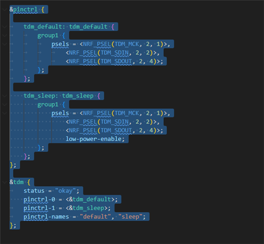

How to config the tdm port on nrf54lm20
I want to try the tdm function on the nrf54lm20 dk.
But i have encountered problem in the first step.

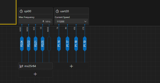

I do not know how to add the tdm port and assign the pin.
Whin i enable the tdm in the device tree, there is nothin in this page.
only this code generated in the overlay files
I try to assign the pin:
But seems invalid...
Can you help me to pass the first step?
Thank you very much!
    Here is a simplistic sample a colleague of mine made, where I added a overlay example for nRF54LM20A:
    hello_world_i2s_lm20a.zip
    Please note that you cannot use P2 for TDM purposes:
    https://docs.nordicsemi.com/bundle/ps_nrf54LM20A/page/tdm.html#d1594e1438

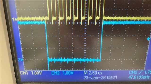

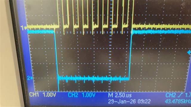

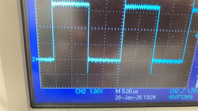

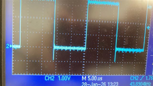

    But the lrclk seems not very accuracy when it is 44.1K
    When i config it to 48K, it will be more accuracy:
    Do you have the same problem?
    Thank you again!
    The TDM can be sourced via two clocks, as shown here:
    44100 Hz is not exactly possible with these two clock sources, so you will have a bit of a miss, but 210 Hz off is a bit much.

  • Hello Håkon
    Thank you for your help.
    I followed your advice and tried your code, add the clock_init.
    But seem that the clock is worse...
    44.1K
    48K
    Do you have any suggestions for this?
    My apologies, my former response is not correct, as the word sync (44.1k in this case) is sourced from the CLK signal.
    Wanted CLK signal is 2*16bit*44.1kHz = 1411200 Hz.
    Since 32M/1.4112 MHz is not equal to an integer, it the nearest is 32M / 23 = 1.3913 MHz.
    However, if you switch to the 24 MHz clock source, you will be much closer to the wanted 44.1 kHz:
    24000 / 44.1 = 17.007 (44.13 kHz)
    The caveat at this time is that the zephyr driver does not support this clock source yet for the nRF54LM20, which I will report internally.
    Håkon
