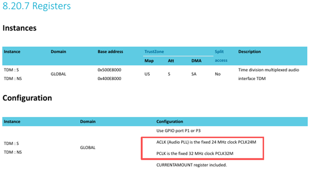

    However, if you switch to the 24 MHz clock source, you will be much closer to the wanted 44.1 kHz:
    24000 / 44.1 = 17.007 (44.13 kHz)
    I have read the page you shared to me and the datasheet of nRF54LM20A, if i change the "
    mck-clock-source" to ACLK, seems it is the 24M? Do I understand correctly?
    The caveat at this time is that the zephyr driver does not support this clock source yet for the nRF54LM20, which I will report internally.
    Or you mean that now i can not use ACLK as “mck-clock-source”?
    Yes, this shall change the clock source for MCK output, but I would recommend that you double-check the SCK/WS output to ensure that those are correct.
    As mentioned, the driver is not fully supporting these features, it seems.
