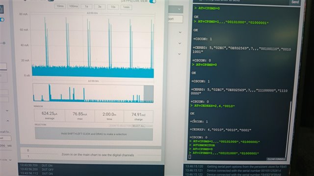

    1. I set the modem LPM. The average current is about 500uA in LPM. Why is it still so high? What is nRF9151 drawing current for? Is it because nRF9151 UART is still enabled?
    2. I press button 1 on the DK, the average current went down to 3uA.
    3. I press button 1 again, it seems to wake the nRF9151 up, with average current about 500uA again, but I lost all network configurations.

    The button is connected to the UART DTR pin. All the documentation about the UART is here.
    What is the proper way to go into deep power save mode, assuming I am using this Serial LTE Modem firmware in my final product?
    All our normal power saving techniques (link) still applies for the Serial Modem add-on.

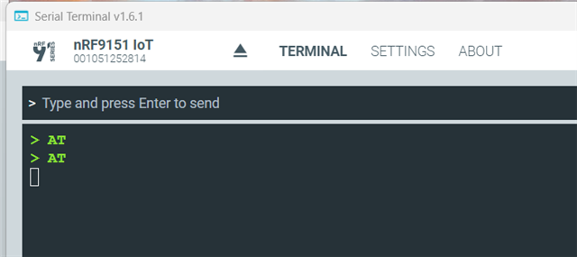

    There are some instances, when I leave the DK alone for maybe 10 mins, then I tried to send a AT command, the DK is not responsive in the sense it did not send back "OK" or network messages. However, my AT command was executed (based on the current profile of the Power Profiler II). Is this a know issue? Below image shows this error. In the image, bottom right, a few AT commands are sent but there were not response received.
    This is not an issue that I know of. I wasn't able to replicate it. Can you please document what you did a bit better so that I can try to replicate it?

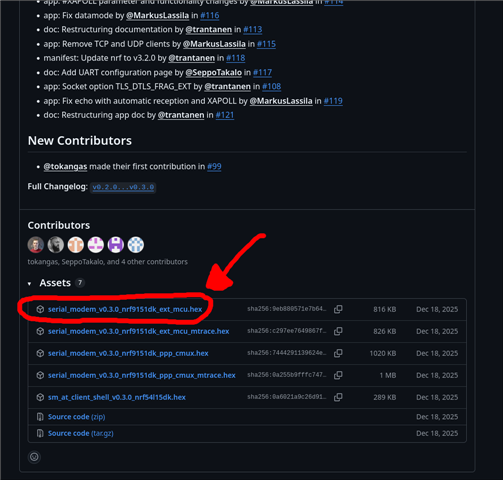

    I have a external host MCU that will communicate with nRF9151 using AT commands. I want to use nRF9151 as a Serial LTE Modem. Meaning I do not want to modify any of the firmware (application and modem). I will just program whatever production-certified modem firmware and application firmware without any recompilation, which means I won't need to use overlay-external-mcu.overlay. Is this possible?
    Yes it is possible, we have a version already compiled with the "overlay-external-mcu.overlay" on the Github page of the application.

    All the AT commands usable with the Serial modem add-on are split between the "normal AT commands" and the "custom AT commands".
    The command to get into different power modes are %XSLEEP and %XSHUTDOWN.

    'Yes it is possible, we have a version already compiled with the "overlay-external-mcu.overlay" on the Github page of the application.'
    Great that there is an 'off the shelf' hex file that we can use immediately without any coding and compilation required.
    • Is this hex file the same one used in nRF Connect Desktop, Serial Modem? i.e. Is the one used in the quick start in nRF Connect Desktop, serial modem, compiled with "overlay-external-mcu.overlay"?
    • Is this hex file for the application MCU only? Or does it also includes the modem firmware/stack? Do I need a separate hex file, i.e. 1 for application MCU and another for modex?
    • Can I use this hex file in the DK? Will it have any hardware conflict?
    No, the one flashed by the "Quick Start" application from nRF Connect for Desktop is not compiled with the overlay. It may also be a few versions older than the one on the GitHub.
    In our nRF91 chips, we have 2 cores: The Application core, which contains the Serial Modem add-on in your case. And a modem core which contains the modem firmware. They are both programmable independently.
    The .hex you download are only for the application core. If you want to update the modem core, you can follow this guide. You can also download the modem firmware on the nRF9151 product page, in the "Download" section. (if you download it from the product page, do not unzip the file before programming. You need to give the whole zip to the "programmer" app).
