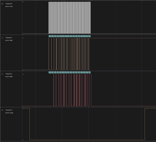

I would like to run the tests at zephyr/tests/drivers/spi/spi_controller_peripheral as intended in testcase.yml. I can verify that I have the correct pins setup, as seen in the SPI traces below.

I can use the following on both boards to run one of the tests (using the 8MHz overlay), and I can see some good output on the SPI lines with a logic analyzer
$> west build -b nrf54lm20dk/nrf54lm20a/cpuapp . -T drivers.spi.spi_8MHz
$> west flash
But I can't see any test results from ztest. Furthermore, it seems to only run test_basic(), which perhaps fails? Because it only does this once.

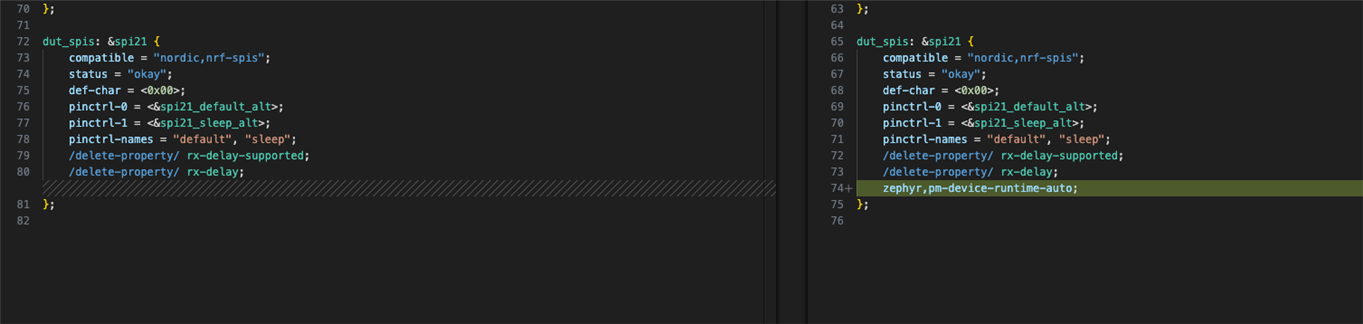

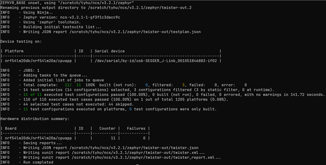

  • Hi segl-nordic,
    Using the command above that you supplied me, I can indeed confirm that it works with or without zephyr,pm-device-runtime-auto;.
    This was the result when I ran with and without the device tree changes. (Note: I removed my changes to the prj.conf file so that Twister can communicate with the serial port).
    However, when I simply flash one of the tests, then it does not work without zephyr,pm-device-runtime-auto added.
    Using the Logic Analyzer, I can see that there's far less traffic on the SPI lines than if I run it manually as before, using:
    $> west build -p -b nrf54lm20dk/nrf54lm20a/cpuapp . -T drivers.spi.spi_8MHz
    $> west flash
    I haven't dived into the details, but I'm wondering if it's only running a subset of tests, rather than a full list of tests, when using Twister.
    Does this make sense? What could the explanation for this be?
