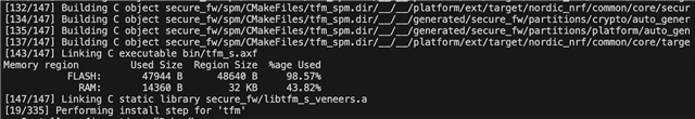

    For thingy53/nrf5340/ns targets where the TF-M overflows FLASH significantly, can we not use the external FLASH?
    Best Regards,
    Ravi
  • Hi Vidar,
    I tried the following.
    • Added CONFIG_RESET_ON_FATAL_ERROR=n to prj.conf
    • Built a debug version of  thingy53/nrf5340/cpuapp/ns target
    • Got build errors with TFM FLASH overflow
    /nordic/ncs/v3.2.1/nrfxlib/crypto/nrf_oberon/lib/cortex-m33/soft-float/liboberon_3.0.17.a && :
    /opt/nordic/ncs/toolchains/322ac893fe/opt/zephyr-sdk/arm-zephyr-eabi/bin/../lib/gcc/arm-zephyr-eabi/12.2.0/../../../../arm-zephyr-eabi/bin/ld: address 0x1c300 of bin/tfm_s.axf section `.TFM_UNPRIV_CODE' is not within region `FLASH'
    /opt/nordic/ncs/toolchains/322ac893fe/opt/zephyr-sdk/arm-zephyr-eabi/bin/../lib/gcc/arm-zephyr-eabi/12.2.0/../../../../arm-zephyr-eabi/bin/ld: address 0x1fc40 of bin/tfm_s.axf section `.gnu.sgstubs' is not within region `FLASH'
    /opt/nordic/ncs/toolchains/322ac893fe/opt/zephyr-sdk/arm-zephyr-eabi/bin/../lib/gcc/arm-zephyr-eabi/12.2.0/../../../../arm-zephyr-eabi/bin/ld: bin/tfm_s.axf section `.TFM_DATA' will not fit in region `FLASH'
    /opt/nordic/ncs/toolchains/322ac893fe/opt/zephyr-sdk/arm-zephyr-eabi/bin/../lib/gcc/arm-zephyr-eabi/12.2.0/../../../../arm-zephyr-eabi/bin/ld: region `FLASH' overflowed by 15856 bytes
               FLASH:       64496 B      48640 B    132.60%
                 RAM:       14560 B        32 KB     44.43%
    collect2: error: ld returned 1 exit status
    CONFIG_PM_PARTITION_SIZE_TFM suggests TFM FLASH size can be increased.
    • Resolved TFM overflow by disabling TFM logging and increased TFM partition size to 256kB (0x40000)
    CONFIG_TFM_PROFILE_TYPE_MINIMAL=n
    CONFIG_TFM_LOG_LEVEL_SILENCE=y
    CONFIG_PM_PARTITION_SIZE_TFM=0x40000
    • Build was successful.
    • Disabling TFM logging was enough to prevent TFM FLASH overflow in this "cfb" sample
    • However, the TFM partition size remained the same.
    • Why hasn’t the FLASH region size changed to 320KB (0x40000) as per link above? Thanks.

    The sample "cfb" for NS build runs successfully.  However, for a typical NS application with BT, the TFM size would be greater than the default ~47.5KB.
    How do I configure CONFIG_PM_PARTITION_SIZE_TFM correctly? Thank you.
    Best Regards,
    Ravi
  • Hi Ravi,
    The thingy53 board includes a static memory partition file to ensure consistent memory layout for all samples built for this board and keep compatibility with the version of the bootloader that comes pre-programmed on the board. But when you have an external debugger you can safely change the memory layout without worrying about bricking the device.
    The static partitioning file takes precedence. If you want to allow dynamic allocation, you need to remove this partitioning file from the board directory: https://github.com/nrfconnect/sdk-zephyr/blob/ncs-v3.2.1/boards/nordic/thingy53/pm_static_thingy53_nrf5340_cpuapp_ns.yml
    Vidar
