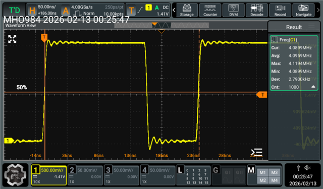

  • Hey Elfving!
    I added the function and it is running now.
    I’ve attached a screenshot from our oscilloscope below. The average frequency is close to 4.096 MHz, which looks fine. However, the measured deviation is about 2.7 kHz, which corresponds to roughly 660 ppm.
    Theoretically the quarz should have a lower jitter, right?
    Additionally, the duty cycle is not symmetric.
    Do you know how ACLK is generated internally? We’re trying to trace where these inaccuracies are introduced.
    Most importantly, we need the clock to be stable over time with no long-term drift.
    Thanks for all your help :)
    Cheers, Rafael
    I think it should be 15ppm, so I agree this looks high. But I didn'tthink it would show itself as jitter. Are you seeing this with eg. a spectrum analyzer as well?
    I would expect the jitter to become a bit worse with the i2s division as well. Are you seeing the same with the pure clock signal bypassed or just with this split?
    Regards, and have a good week-end,
    Elfving

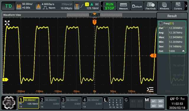

  • Hey Elfving,
    so, selecting bypass isn't directly possible in Zephyr; I cheated a bit and temporarily set ".enable_bypass = true" in ncs/v3.2.1/modules/hal/nordic/nrfx/drivers/include/nrfx_i2s.h.
    The result is a frequency around 12,288MHz, but we can see an even higher deviation of about 19kHz, resulting in around 1500ppm.
    At the same time, the duty cycle seems stable now. I suppose the distorted duty cycle we saw above stems from the MCK generator.
    For us, it is mostly important that the frequency is stable long-term, and doesn't drift. The relatively high jitter mainly makes us cautious about the clock source and its determinism.
    hfclkaudio comes from the 32MHz HFXO crystal. The 12,288MHz hfclkaudio can not be achieved through simple division of 32MHz. Do you know, how hfclkaudio is created internally? If we know it to be deterministic, so no delay being introduced, we could exclude an additional drift, that would suffice for us.
    Best regards
    Rafael

  • Hi again, and thanks for the patience.
    I am not sure if I understand - what is the deviation you are seeing if not duty cycle?
    I would also recommend that you check this with a frequency analyzer, even though 4GSa/s does sound okay.
    Understood. Though this depends on the HFXO, you can always choose a crystal with better properties if you prefer. I wouldn't say that we've found out that there is a 1500ppm jitter here, but even if it were that, shouldn't lead to drift.
    This might help if you want more of a technical understanding.
    Elfving
