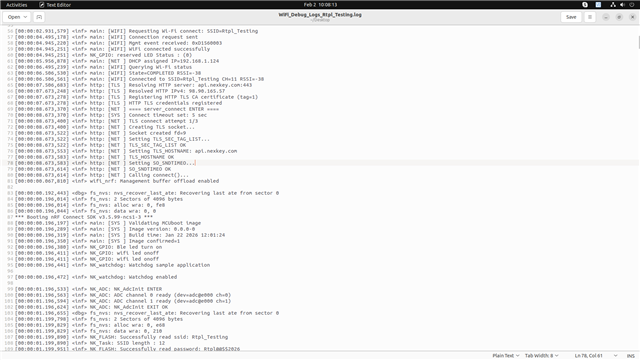

We are facing intermittent issues while establishing a TLS connection to a remote server when the device is connected via a Wi-Fi router network.
The firmware gets stuck at the following API call:
connect(sock, (struct sockaddr *)&server, sizeof(struct sockaddr_in));
In many failure cases, the device reboots unexpectedly while blocked in this call.
Occasionally the connection succeeds, but application-level communication does not occur even after a successful TLS connection.
When using a mobile hotspot, the same firmware works reliably:
  • TLS connection succeeds
  • Data exchange works as expected
  • No unexpected reboots observed
Observed Behavior
  • connect() sometimes blocks indefinitely when using a Wi-Fi router
  • Device reboots during or after the connect() call
  • In some cases, TLS connection is established, but no data is exchanged
  • Behavior is intermittent (sometimes works, often fails)
  • Mobile hotspot works consistently with the same firmware and server

    Q1: Have you tried to use a newer SDK version, for instance NCS v3.2.1, to see if the issue persists?
    Q2: What is the watchdog timeout configured to?
    Håkon
  • Q1: Have you tried to use a newer SDK version, for instance NCS v3.2.1, to see if the issue persists?
    Answer : We have already attempted to migrate the application to NCS v3.2.1. However, with the current state of the port, after flashing the firmware the device does not produce any logs and no application behaviour is observed.
    Answer : The watchdog timeout is currently configured to approximately 10 seconds.

    Q1. This is my current project config file can we still optimise RAM memory ?
    Q2. Sometimes logs showing below error :
    wifi_nrf: nrf_wifi_fmac_rx_cmd_send: No space for allocating RX buffer
    wifi_nrf: nrf_wifi_fmac_rx_event_process: nrf_wifi_fmac_rx_cmd_send failed
    wifi_nrf: nrf_wifi_fmac_data_event_process: Failed for event = 3
    wifi_nrf: nrf_wifi_fmac_data_events_process: umac_process_data_event failed
    wifi_nrf: hal_rpu_eventq_process: Interrupt callback failed
    How we can resolve this ?

    This is a allocation issue, usually related to the heap.
    DipeshParikh_ said:
    CONFIG_HEAP_MEM_POOL_SIZE=131072
    What ncs version are you currently running?
    If still on v2.6.2, could you please update to the latest v2.6.5, to see if the issue still persists?

    Below is my overlay file :

    One more thing that we made below driver level changes for OTA in v2.6.2.
    v2.6.2 nrf/samples/common/mcumgr_bt_ota_dfu/Kconfig
    commented below line at provided path due to some error we faced while building the firmware and for OTA.
    imply NORDIC_QSPI_NOR if (dtchosenenabled,(dt_chosen_enabled,(dtc​hosene​nabled,(DT_CHOSEN_EXT_FLASH))
    After this changes we are able to build the firmware using the v2.6.2.
    We are using MX25R6435F external flash for the OTA it is use SPI and Wifi chip is use QSPI.
    Can you please help me how can i resolve this error.
