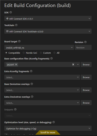

I am facing a build issue while working with the following environment:
Environment
  • SDK: nRF Connect SDK v1.9.1
  • Hardware: nRF9160 DK (custom board)
  • Toolchain: v2.0.0

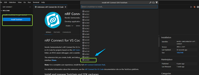

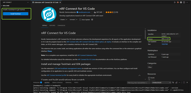

Since older toolchain versions (v1.x.x) are no longer supported, Toolchain v2.0.0 or later is required for building and execution. However, I am currently unable to build my project using Toolchain v2.0.0 with NCS v1.9.1.
I am encountering the following error during the build process:
west build --build-dir d:/im830/build d:/im830 --pristine --board im830_nrf9160_ns -- -DNCS_TOOLCHAIN_VERSION="NONE" -DCONFIG_DEBUG_OPTIMIZATIONS=y -DCONFIG_DEBUG_THREAD_INFO=y -DCONF_FILE="prj.conf" -DBOARD_ROOT=d:/im830

I would like to know:
  1. Is it officially supported to build an application using NCS v1.9.1 with Toolchain v2.0.0?
  2. If not, is there any recommended workaround or migration approach?
Your guidance and suggestions would be greatly appreciated.
