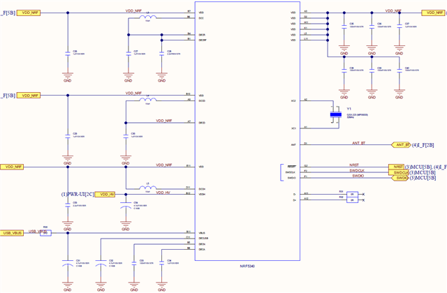

nRF5340 does not start when powered only from 5V main supply in High Voltage mode
I am currently working with an nRF5340 configured to operate in High Voltage mode, where the main input supply is 5 V.
Issue description
When the nRF5340 is powered only from the main 5 V input, the cores do not appear to start or run correctly.
However, the device behaves normally when an additional 3.3 V reference is present.
Specifically:
  • If 3.3 V is applied to the JTAG VREF pin, the cores start and run normally.
  • If a 3.3 V signal is present on a GPIO (UART RX pin), the cores also start and run normally.
  • Without either of these conditions, the cores do not seem to run when only the 5 V main supply is applied.
How the core activity is verified
I verify whether the cores are running by:
  • Monitoring console UART TX output using an oscilloscope
  • Observing the behavior of LEDs connected to GPIO pins
When the issue occurs:
  • No UART TX activity is observed
  • GPIO-connected LEDs do not toggle or behave as expected
When 3.3 V is present on JTAG VREF or UART RX:
  • UART TX output appears correctly
  • GPIO LEDs operate normally
Power supply design
  • The power circuit is based on the nRF5340 DK reference design
  • The device is intended to run in High Voltage mode with a 5 V main input
  • No significant deviation from the DK power topology is intended

  • Default VDD output is 1.8V, which some 3.3V J-Links don't like much - and it also not enough to light LEDs (unless they have red color).

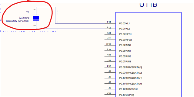

    We have also seen this behaviour when the LF clock was not properly configured, and I don't see LFXO in your schematic. Sample code from a DK requires LFXO to be present. No idea if you also needed changes for your HFXO..?
    You can try running blinky and measure the voltage on the LED pin with a multi meter. May still need changes in the dts overlay for oscillators.
  • Thank you for the reply. I would like to add some clarifications, test results, and also ask specifically about the GPIO voltage level.
    • LFXO is present on the board
      I did not upload the LFXO schematic previously, but the board does include an LFXO.
      It is connected as shown in the attached schematic image, following the same configuration as the nRF5340 DK.

    • VDD output confirmed at 3.3 V
      I programmed the UICR with the following command:
                               nrfjprog --family nrf53 --memwr 0x00FF8010 --val 5
                After this, I measured the VDD rail and confirmed that 3.3 V is present on VDD.
