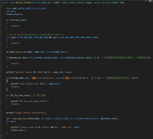

I am adding a feature to our device to actively connect to a Bluetooth printer and send data to it, but I am now encountering an issue that I cannot solve.
I currently have three Bluetooth printers, which I refer to as a, b, and c. a and b are the same model, while c is from a different brand. When connecting these printers using our developed 52833 device, connecting a is very stable, almost without any RF noise issues. Connecting b has lower stability and occurs more frequently with this problem. However, connecting c has never succeeded; as soon as the connection starts, it gets disconnected immediately. The disconnection reason is 0x3e, which is BLE_HCI_CONN_FAILED_TO_BE_ESTABLISHED
These three printers should all be working properly. I connect them with my phone, and there won't be any issues; they can all be used normally
So how should this problem be solved?

  • I noticed an issue in the log: after the device starts searching for a characteristic UUID, the connection is disconnected first, and then the printer replies with the search UUID packet. I compared the log of a normal connection and can confirm that this order is problematic, but it seems to be caused by another issue due to 0x3e, rather than the cause of the 0x3e issue

    This is the code I used for testing. In this callback for scanning devices, if the target device is scanned, it will first stop scanning and then connect, which is the same process as in the example.
  • I feel like the problem shouldn't be with my code, because I have two identical printers, connect them separately with the same device, and the success rate of connecting one printer is very high and the other is very low. But when I connect these two printers separately with my mobile phone, the connection success rate of both printers is 100%
