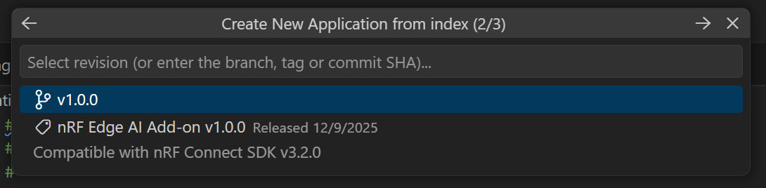

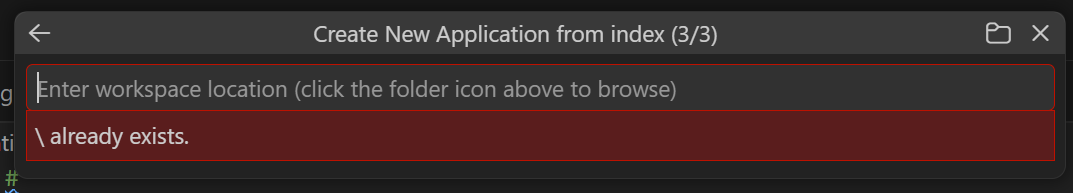

Issue 2: Adding the nRF Edge AI Add-on shows “Already exists”
Background
I’m trying to use the nRF Edge AI Add-on, which is selected from:
→ Create a new application
→ Browse nRF Connect SDK Add-on Index
→ Edge Ai Add-on
Notes
  • I have never installed this add-on before
  • I also cannot find any local files related to the nRF Edge AI Add-on content that I see in the GitHub repository(nrfconnect/sdk-edge-ai: Edge AI add-on)

    Issue 2:
    Could you try to click on the folder icon in the top right and maybe select the folder, say, c:\ncs\edge_Ai ?
    At present what it means is that your folder already exists, i.e. you need to create a new folder in order to install it into. So what I did is that, in my existing path, of c:\ncs , I am asking it to create a new folder called edge_Ai and install it into that folder.
    Please try it this way.
