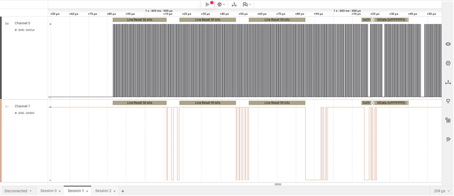

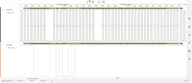

    First, thank you for your expert advise and guidance. I would like to ask once more for your help as I think I uncovered something significant, and I believe a Nordic expert is needed to answer my question.
    Bottom line - I believe my custom board is pulling down the output voltage of the SWDIO and SWCLK lines of the DK or J-Link)
    In order to confirm the signaling is correct between the DK (or J-Link) and my custom board I connected only the necessary signal lines (SWDIO, SWCLK, GND and SWO_SEL) using breakout boards and jumpers. The DK and the J-Link both continued to give the same errors (they cannot connect to the custom board). I then attached my oscilloscope and logic analyzer to the lines. The O-scope showed data and clock on the respective lines, but the voltage shown was only 2.23V. My logic analyzer was able to decode the data and clock even with this reduced voltage and I have attached a couple of screen shots of that data (I looked for SWD protocol info for Nordic and J-Link to understand what was sent but I have not been able to locate that info yet - perhaps you can analyze the signals and tell if there is comms between the custom board and DK - or if the data is only that which the DK sends out - with no response. This is my hunch). I then removed the SWDIO and SWCLK signals from the custom board and connected them only to the o-scope. I then tried to connect the JLink probe to the custom board. The o-scope showed SWDIO data at 3.1V. So it appears that the custom board is pulling the signal lines low enough (2.3V vs 3.1V) that they are below the voltage threshold for a "1".
    Going back to my previous note, could the fact that VDDH is floating, and not tied to VDD cause this? If not what else could cause this phenomenon? On my PCB, SWDIO and SWCLK are point to point from the RAYTAC module to the connector (and a test point) - so nothing else could be pulling them low.
    Thanks for your help,
    Lonnie
