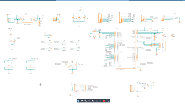

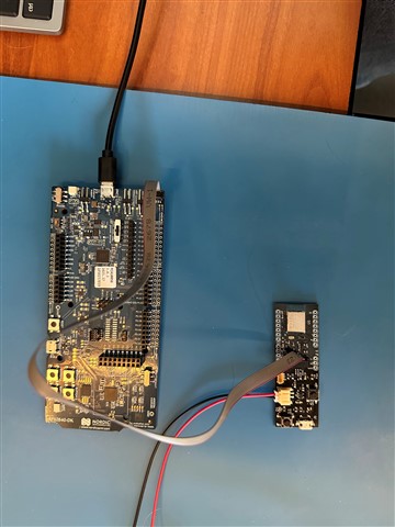

I designed the board (based on the Adafruit nRF52840 feather and assembled it myself. This is the first time I've used the Raytac module, so I don't know exactly how to prove it is working correctly before flashing it. I have attached a picture of the flashing setup - my board and the SDK with ribbon connector, and a picture of my schematic for reference. Here is the text from the Output and Terminal windows in nRF Connect extension for VS Code:

    This sounds strange. The setup looks correct here. A common mistake is that the 10-pin cable is connected the wrong way if you don't have the 10 pin header with plastic to make sure it can only be mounted one way.

    Is this the full schematics of your board? Which of the headers in the schematics is the 10 pin header?

    Thanks for the reply. I copied much of the design from the nrf52840 feather, including the connectors and their pinouts, and I checked voltages while my board was connected to the DK - and they look correct - so I think the 10-pin cable is connected correctly. The schematic attached is the full schematic (it is a test board with access to I2C and some GPIO pins that I can use to test code and various sensors before I spin a production board) and J2 is the 10 pin header - it is center bottom of the schematic.

    The behavior here definitely sounds like a hardware issue since neither the DK or the J-Link is able to connect to it.
    I asked one of my colleagues with more HW expertise than me. There is nothing obviously wrong, but for possible future revisions, you can improve the grounding in general on your board.

    You can also, just to try connect the 10 pin cable 180 degrees the other way in case that is the issue (a common one if the header isn't supported with plastic to show which way it should be connected).
