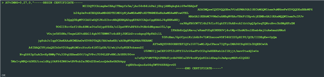

  • this is how certificate manager conditions the certs into the modem
    not sure what those characters are in between
    Thanks for the update. The characters you see between the certificate lines are standard line endings that Certificate Manager adds automatically which I think should not be the issue.

  • I believe the modem expects those line endings CR/LF , and that's the reason its working.

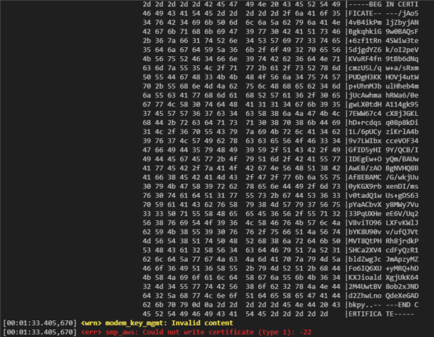

    I did some hexdump before I try flashing it in the modem and the modem returns -22 [Invalid Content].
    regarding your questions,
    1.No Adapter, we have a seperate data path that is responsible to get the data to the modem, but we are confident that the large data reaches the 9151 modem as shown in the screenshot above. I just suspect the modem wants it to be formatted in a very particular way.
    LOG_HEXDUMP_INF((const uint8_t *)write_ptr, write_len, "modem_key_mgmt_write write_ptr");
        ret = modem_key_mgmt_write(CONFIG_AWS_IOT_SEC_TAG,
                                   cred_type,
                                   write_ptr,
                                   write_len);
    2. modem fw: mfw_nrf91x1_2.0.2 for both
    It looks like the certificate is being cut short somehow in the hex dump. But it's hard to say for sure what is going on without the full code.
    Yes, but as you said it also works on the DK. The modem on the DK should take the same format as the one on the custom board I would imagine. So you should try to check what is different in those two cases.
