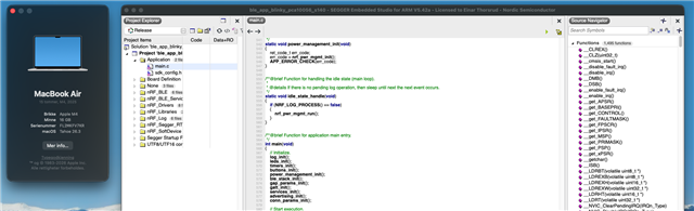

    I wonder if there is something with your configuration that cause problems? I have not found any other reports of this issue with SES fonts being unreadable, other than this which I suspect is also from you? For reference, I am using SES 5.42a on my end on MacOS Tahoe (26.3) without any issues:
    As I am not able to reproduce this is just an idea, but could it be worth deleting all SES configuration files (probably under "~/Library/SEGGER/SEGGER\ Embedded\ Studio"), and see if that helps?

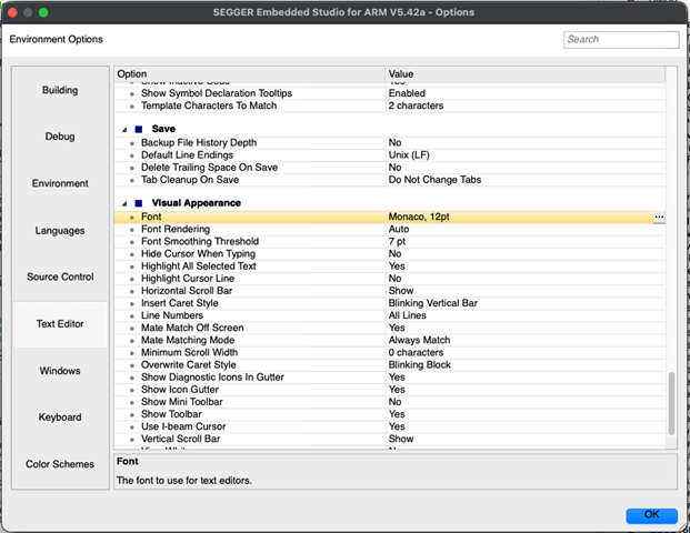

    I'm curious why your SES v5.42a works while mine doesn't. If you go to Tools->Options then select Text Editor, and under Visual Appearance click the "..." button next to Font, does your SES crash? Mine does.
    Let me know. Thanks,
    John
  • Hi John,
    Yes, it crashes on my Mac as well if I click the "..." button. So I am stuck with the existing font it seems, but that is OK in my case, not sure why there is a difference there. For ref, this is the font I am using:
  • My font says "Monospace, 11pt". And though Monospace is supposed to be a constant width font, my code windows are all messed up. Do you know of any way for me to change the font without using their Options window?
    The settings is in an XML file, so it should be OK to modify that. Typically that would be under ~/Library/SEGGER/SEGGER\ Embedded\ Studiov3/settings.xml, where the font is set in settings name "Text Editor/Font".
    I have one machine where it is set like this (here the font size is larger than in the screenshot in my previous post):
      <setting name="Text Editor/Font">Monaco,14,-1,5,50,0,0,0,0,0</setting>
