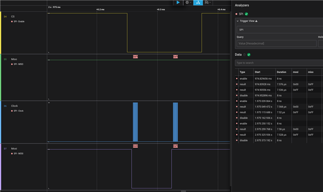

I have been struggling for the past couple of days to try to get the SPI working. I never thought that something this easy could have become such a nightmare.
I tried compiling and running sample test from Lesson 5 of the Intermediate course (SPI). The problem with the sample is that I always get back 0xFF when I read back from the registry.
I have a bmp390 and I'd be very happy to read back a nice 0x60 value from chip id (registry 0x00), but so far all I was able to read is 0xFF, as you can see from the trace below.
This video shows something very similar to the sample files
https://www.youtube.com/watch?v=zStXcr2Fi44
I tried to write the same code and still get 0xFF. I tried to send a read 0x80 after the registry but nothing worked.
During this painful investigation, I found that for some reasons i am not even able to control some pins (ie pin 9) on the dk.

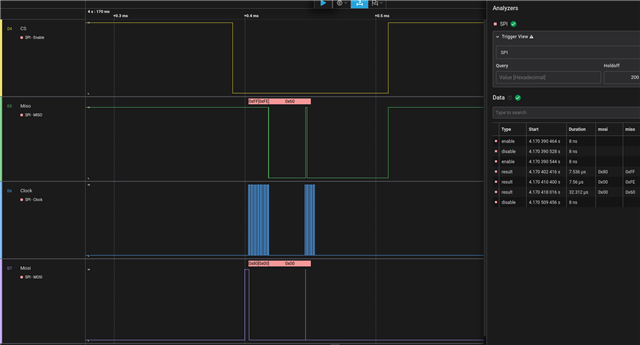

    However on nrf52dk I am receiving back the following values from the transmission:
    FF FF 40
    While the logic analyzer shows
    FF FE 60
    I am wondering what is causing this discrepancy as the correct registry value for the BMP390 is 0x60.

    CS pin is part of any SPI node as child node so zephyr will not associate any CS with that bus. There is previous case (+) The cs pin of the spi is not working - Nordic Q&A - Nordic DevZone - Nordic DevZone you can look at.
  • Thank you, Kazi, for guiding me in the right direction. I've uploaded a complete working solution to this GitHub repository, hoping it will assist others facing the same issue:
    nrf52-zephyr-rtos-spi
    After setting up CS within the SPI node configuration, I successfully established communication. No need to manually control CS. The key was to configure the SPI in the overlay file in this manner:
    &spi1 {
    	status = "okay";
        pinctrl-0 = <&spi1_default>;
        pinctrl-1 = <&spi1_sleep>;
        cs-gpios = <&gpio0 11 GPIO_ACTIVE_LOW>;
        spi_node: spi-dev-a@0 {
    		reg = <0>;
    Thank you again and have a great weekend.
