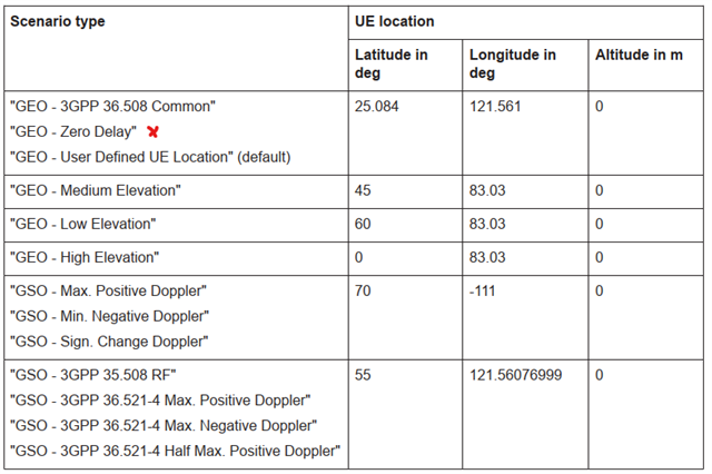

    at%location=2,"25.08439333","121.56076999","0",0,0 - sets UE location (default 3GPP GSO location specified in 3GPP 36.508 chapter 4.13).
    AT%XLABAPP=12,1 - deactivates UE prediction of satellite trajectory if required.
    The team have tested CMW500 NBIOT FW version 4.0.250 which has support for NTN. It has many satellite scenarios for NTN:
    x For “GEO - Zero Delay” location needs to be Lat-"0.0" Long-"121.561" Alt-"35785998.3"
    For RF-related testing I have used scenario “GSO - RF”.

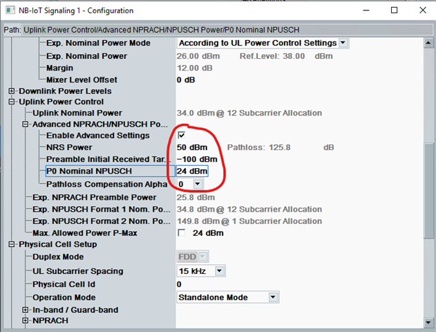

    ・TX output power always at maximum and preventing idle disconnect
    Is my understanding correct that there is no UE‑side setting to force the terminal to always transmit at maximum output power, or to prevent the connection from being released even in idle conditions?
    Do I have to adjust the network side settings?
    As default in NB1-mode the DL power level received by the UE affects its UL power level.
    One way to force DUT to use max Pout level is to LOWER DL level ~10dB AFTER establishing a call.
    Another way is to “decouple” UL and DL power levels in CMW settings by enabling Advanced Power Control and setting pathloss compensation to zero.
    For max UL Pout the settings can be something like this:
    Waiting for feedback on your other questions.
    Kenneth
  • Sorry for the late response.
    Thanks for your guidance. I was able to resolve the TX output power issue using the settings you suggested.
    I would appreciate your comments on the remaining questions as well when you have time.
