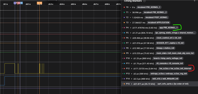

I am trying to improve boot time and here are some spikes and timings.
What I have found out is that CryptoCell init (hw_cc3xx_init_internal) takes majority of PRE_KERNEL_1 time.
As Crypto is not used early in the application, idea was to defer init of the driver, but I didn't had any success.
I've tried to comment out both SYS_INIT for hw_cc3xx_init (with and witout mutex), commented out entropy_cc3xx_rng_init, commented out _psa_crypto_init SYS_INIT and called those functions from main().
This is not working, board keeps rebooting
just for a test:
* I've tried to disable completely CC312 hardware and use Oberon instead without success.
* I've also tried to set zephyr,deferred-init; for &cryptocell. This just makes device disabled, but that 171ms function is still called in PRE_KERNEL_1
Do you have any recommendation how to make CryptoCell driver initialization later, during application run?

  • Thank you for the update. I was actually just looking into this when you posted this. hw_cc3xx_init_internal() initializes the RNG by calling nrf_cc3xx_platform_init(). While the zephyr,deferred-init property added to the cryptocell node correctly defers the entropy driver initialisation, it does not matter because the RNG is already being initialised by hw_cc3xx_init_internal(), which is not gated by this zephyr,deferred-init property that only applies to device drivers.
    I did the following in my test:
    1. Patched the hw_cc3xx.c file with this:
    diff --git a/drivers/hw_cc3xx/hw_cc3xx.c b/drivers/hw_cc3xx/hw_cc3xx.c
    index b4218477e4..88d34b772d 100644
    --- a/drivers/hw_cc3xx/hw_cc3xx.c
    +++ b/drivers/hw_cc3xx/hw_cc3xx.c
    @@ -25,13 +25,13 @@ static int hw_cc3xx_init_internal(void)
     	/* Initialize the cc3xx HW with or without RNG support */
     	/* Using same configurations as the users of entropy, see NCSDK-24914. */
    -#if CONFIG_ENTROPY_CC3XX || defined(CONFIG_PSA_NEED_CC3XX_CTR_DRBG_DRIVER)
    -	res = nrf_cc3xx_platform_init();
    -#elif defined(CONFIG_PSA_NEED_CC3XX_HMAC_DRBG_DRIVER)
    -	res = nrf_cc3xx_platform_init_hmac_drbg();
    -#else
    +//#if CONFIG_ENTROPY_CC3XX || defined(CONFIG_PSA_NEED_CC3XX_CTR_DRBG_DRIVER)
    +//	res = nrf_cc3xx_platform_init();
    +//#elif defined(CONFIG_PSA_NEED_CC3XX_HMAC_DRBG_DRIVER)
    +//	res = nrf_cc3xx_platform_init_hmac_drbg();
    +//#else
     	res = nrf_cc3xx_platform_init_no_rng();
    -#endif
    +//#endif
     	return res;
    2. Then made sure to initialise the device before enabling bluetooth:
    const struct device *c312 = DEVICE_DT_GET(DT_NODELABEL(cryptocell));
        err = device_init(c312);
    	if (err) {
    		printk("Failed to initialize device: %s (err %s)", c312->name, err);
    I don't immediately see any problems with this approach but at a minimum you should check if there is anything else that tries to request entropy data on startup.
