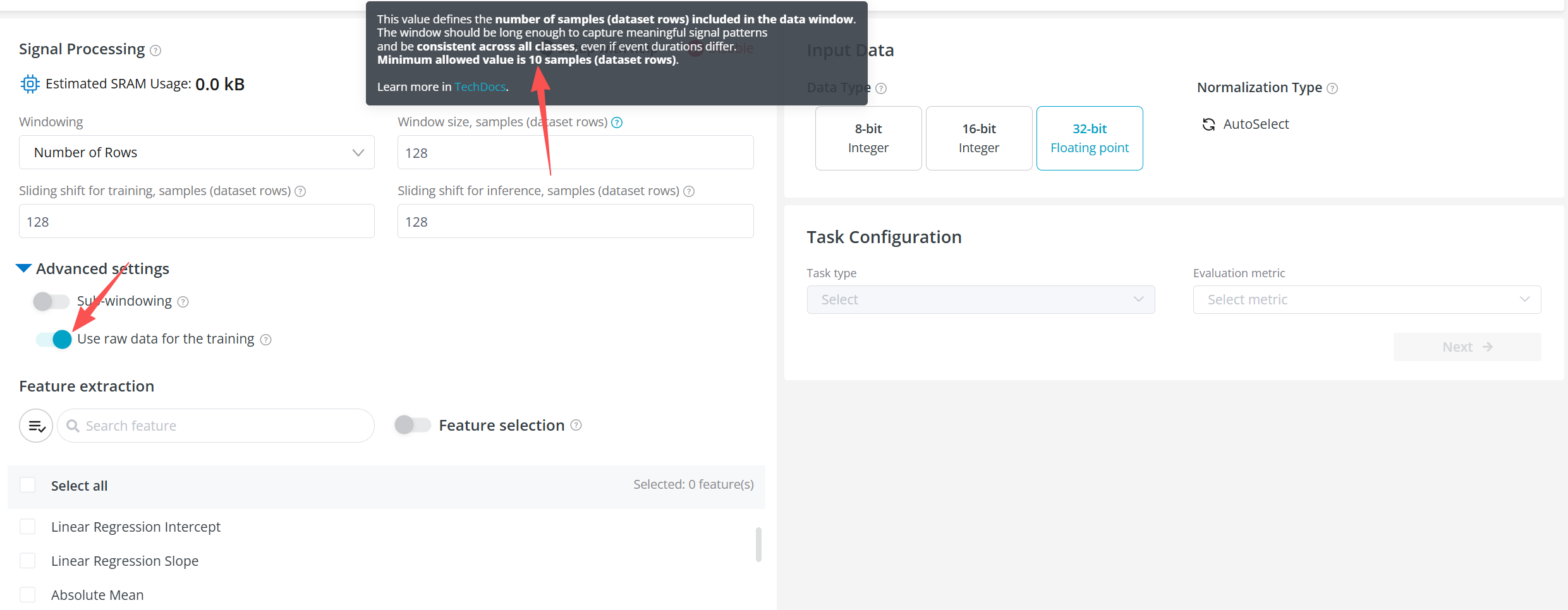

    Despite uploading this pre-featurized dataset, the training configuration interface on ai.lab.nordicsemi.com appears to mandate a "Window Size" parameter. Furthermore, this value must be at least 10 (i.e., aggregating at least 10 rows into one window).
    This creates a logical conflict. For my dataset, where one row equals one sample, setting a window size of 10 forces the platform to incorrectly merge 10 distinct samples into a single new "sample" for training. This completely disrupts my data structure, makes the training process invalid, and defeats the purpose of using pre-computed features.

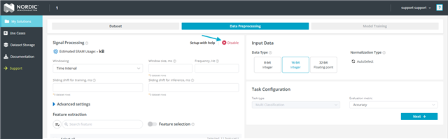

  • There is an option to disable signal processing in the data preprocessing step. Please disable it if you would like to completely bypass the signal processing stage.
    If you plan to use signal processing, please note that a minimum window size of 10 is required for the features to function properly.

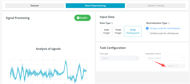

    However, I have encountered two new issues while using the platform, primarily related to the UI functionality. I would like to report them here:

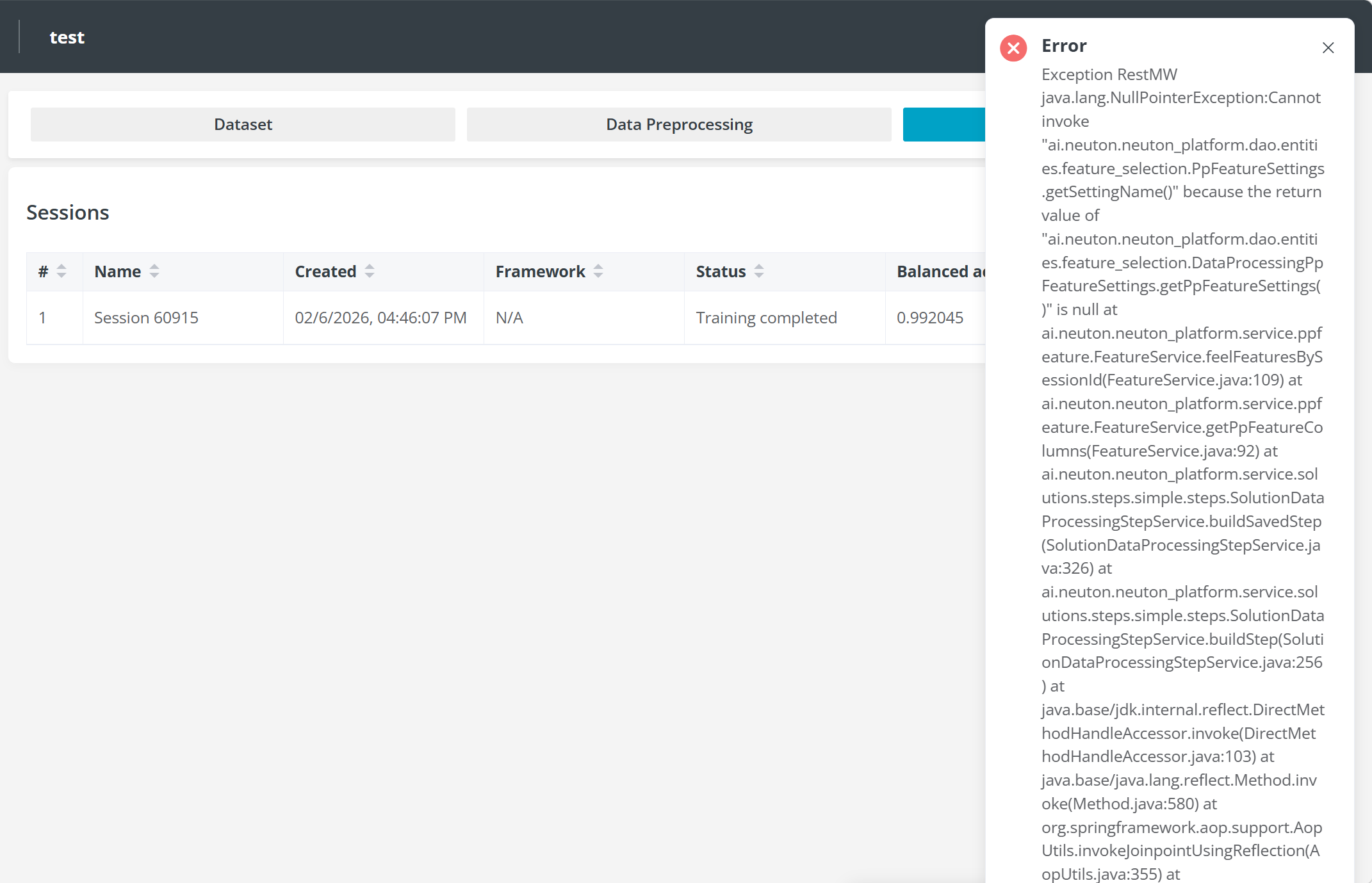

    Issue 1: Data Preprocessing Page Cannot Be Configured
    In the Task Configuration step of the Data Preprocessing page, I am now completely unable to make any configurations or click the "Next" button to proceed. This happens on both newly created projects and previously existing ones. In the rare case where I manage to click Next on a project, an error occurs afterwards (see attached screenshot).

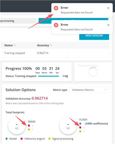

    Issue 2: SRAM/FLASH Values Not Displayed in Solution Options
    For projects that have already completed training, the SRAM and FLASH usage values that should appear in the Solution Options section (under Model Training) are now completely missing.
    I noticed that the ai.lab.nordicsemi.com website has been updated recently. Both of the issues mentioned above appeared after this update and seem to be related to it.

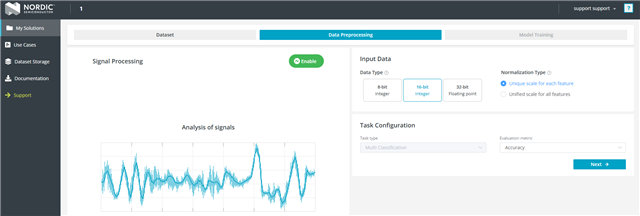

  • The team has recently updated the Edge AI Lab. As a result, previously created and trained solutions will no longer work since the structure of the deliverables on the platform has changed. Therefore, the team suggests that
    If users would like to receive archives of their old solutions, they should specify the Solution ID they need. The Solution ID can be found in the My Solutions tab under the solution name, as shown in the screenshot.
    To avoid any error messages in the UI, users simply need to create a new solution. New solutions will work without issues, while older ones will produce errors due to the platform changes.
