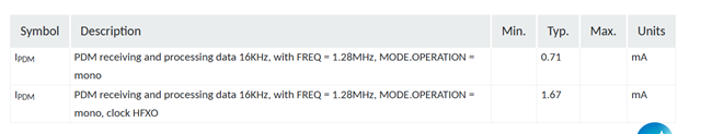

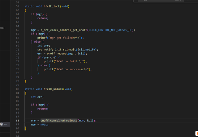

   After switching the 9160 crystal oscillator to an external crystal oscillator, we found that the power consumption of the MCU increased by approximately 1.2 mA constantly, regardless of whether it was in sleep mode or active mode. The switching function we used for testing is shown below.
Is the power consumption increase of 1.2 mA after switching to an external crystal oscillator in line with the actual design parameters of the nRF9160?
