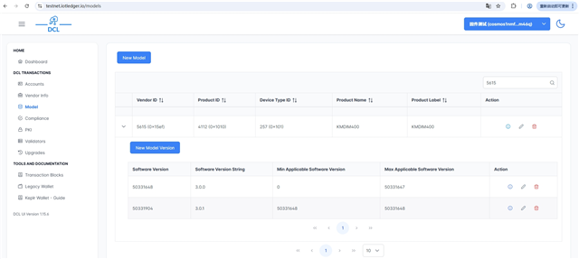

We are reaching out to seek your guidance regarding an issue we’ve encountered while testing Matter firmware updates using the DCL test environment . We have confirmed that the firmware package can be successfully updated via a Raspberry Pi tool. However, when we upload the firmware to the DCL test server(https://TestNet.iotledger.io/) and fill in the relevant information, the Apple app does not automatically prompt the firmware update.
We followed the steps outlined in the document linked below but are unsure if we may have missed something or made an error in the process. Could you kindly share your experience or insights on this matter?
For reference, here is the information we filled in during the process:
[Provide details about the information you entered, e.g., firmware version, product identifiers, etc.]
Link to the document we referenced:
developer.apple.com/.../Apple-Matter-OTA-User-Guide.pdf
We would greatly appreciate any advice or suggestions you might have to help us resolve this issue.

    Apologies for the wait.
    We have not used TestNet DCL for a while, and are not aware of similar reports from other end users.
    Could you let me know if there's any logs from iOS and/or Device which indicates anything wrong?
    Could you double checking versioning and ensuring the version of the FW is indeed lower than one in DCL?
    Andreas
