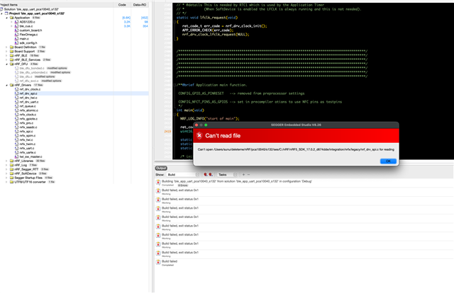

  • Sorry, missed to see that there is a segger project there.
    I tried to build it and I cannot build as there are files that are hardcoded filepaths that does not work with Mac that I have.
    I need to ask for help from my colleague to run this on their Windows machine.

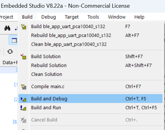

    Yes, you have to do these steps:
    a) download the program in debug mode (Build and Debug):

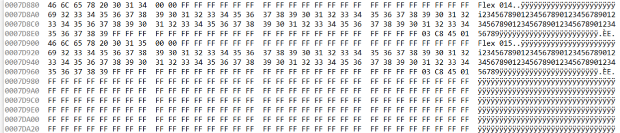

    c) pause the running program and check the flash memory starting at 0x007D000 to 0x007DFFF for last stored entry.
    The data set (128 bytes) starts with the device name, here it is 'Flex 014' and 'Flex 015' .

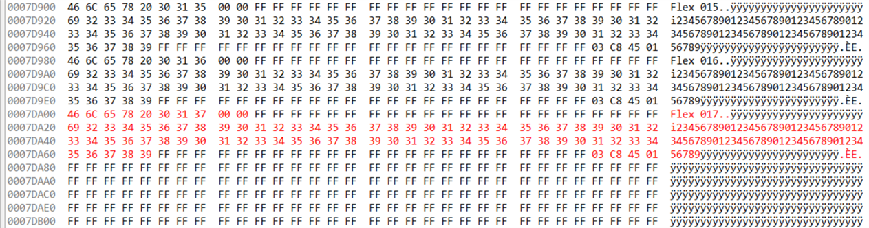

    g) pause the running program and check the flash memory again
    - -> the name should be written to the flash (here in red)
