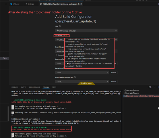

FATAL ERROR: CMake is not installed or cannot be found; cannot build.
Using the 54l15 chip, with the NCSv3.2.1 version, the example is compiled using peripheral_uart.
I have been using this environment for over a year now.

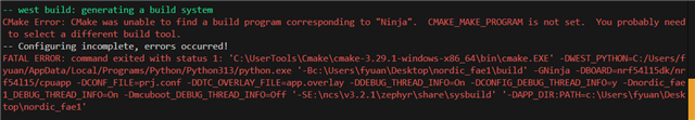

1. When I was compiling today, I encountered the following problem
2. I attempted to delete C:\UserTools\Cmake, but encountered the following error message.

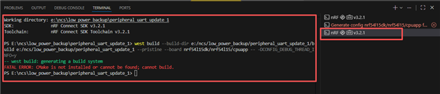

west build --build-dir e:/ncs/low_power_backup/peripheral_uart_update_1/build e:/ncs/low_power_backup/peripheral_uart_update_1 --pristine --board nrf54l15dk/nrf54l15/cpuapp -- -DCONFIG_DEBUG_THREAD_INFO=y
3. I attempted to reinstall the "NRF Connect for VS Code" within VS Code from scratch.
4. I uninstalled all the extensions of VSCode and finally uninstalled VSCode itself. Then I reinstalled them, but still got an error message.
5. Compile using the nrf connet port
The SDK for my NCS is not on the C drive, but on another drive. I'm not sure if this will cause any problems.The SDK is not on the C drive. I have always used it this way.
Could you please take a look at it and help solve it as soon as possible? It's extremely urgent!
Looking forward to your reply very much.

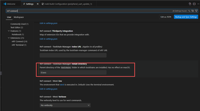

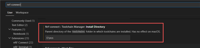

    When I deleted "E:\nsc", and then re-downloaded a new "toolchains" on the C drive.It can be compiled and built normally.
    When I re-added "E:\nsc", and selected "toolchains" as the E drive, the compilation still went smoothly.
    After I deleted the "toolchains" folder on the C drive, the problem of being unable to find Cmake occurred.

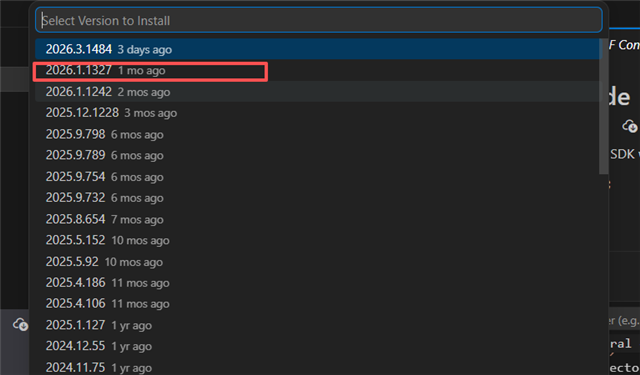

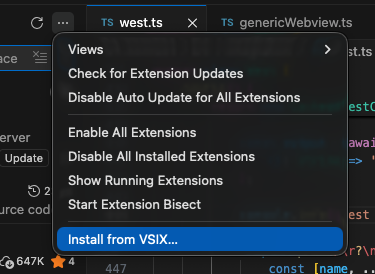

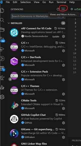

  • There is another case I've seen and it has the correct solution - which is to manually downgrade the extension to 2026.1.1327 version from ~1 month ago.
  • I think the workaround for now is to roll back the VS Code extension version, as  suggests.
