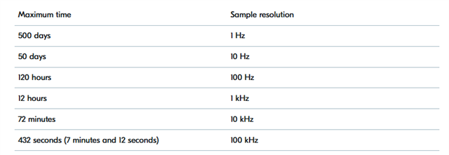

    To rephrase, i see this table which show sample rate variation with the time.
    Can you tell me if I will lose sample numbers for very long measurements ?
    I don't really understand the meaning of this table.
    Thanks for your help,
  • Hi Maxime,
    The table you are referring is from an old blog post. Some of the information in that blog post are not relevant anymore.
    We had that limitation because we used to store the measurement into RAM. But now, we are storing directly to the drive. Which means that now, the only limitation you have, is the space on your hard drive.
    Sorry for the confusion with that blog post.
