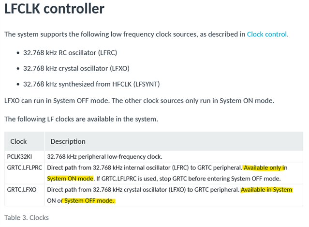

I'm trying to get the nrf54L15 in a Fanstel BM15M to go into the system OFF state and be woken up later by a timer.  All the documentation I've seen says there's an internal LRFC that can be used, and that an external crystal is not required.  After a couple of days of attempting many solutions and tests, I have not been able to get it to do so.

LFLPRC does not actually run in System OFF on nRF54L15, despite:
  • nrf_grtc_timer.c explicitly setting CLKCFG.CLKSEL=LFLPRC when K32SRC_RC=y
  • LFLPRC being described as a low-power oscillator intended for System OFF
Supporting evidence: The Nordic system_off sample targets nRF54L15dk (nrf54l15dk/nrf54l15/cpuapp). A prior build of that sample on this machine shows CONFIG_CLOCK_CONTROL_NRF_K32SRC_XTAL=y — the nRF54L15 DK uses an external LFXO crystal, not LFLPRC. The sample GRTC wake test is only validated on boards with a crystal.
Questions for Nordic
  1. Does LFLPRC actually keep running during nRF54L15 System OFF? Can GRTC generate a System OFF wake event when CLKCFG.CLKSEL=LFLPRC?
  2. Is there an additional initialization step required to keep LFLPRC alive across System OFF — e.g., a specific NRFS request, SYSCTRL domain retention register, or GRTC active_request that must be made before sys_poweroff()?
  3. Is NRF_GRTC_CLKSEL_LFLPRC (value 2) intended to work for System OFF wake, or only for WFI sleep? The Zephyr nrf_grtc_timer.c driver sets this when K32SRC_RC=y, and z_nrf_grtc_wakeup_prepare() relies on it — if LFLPRC doesn't run in System OFF, this API silently does nothing on no-crystal boards.
  4. The Nordic DevZone references LFXO as the only System OFF GRTC clock source (devzone.nordicsemi.com/f/nordic-q-a/117845/grtc-feature-of-nrf54l15). Is this correct for nRF54L15, or is LFLPRC a valid alternative?
