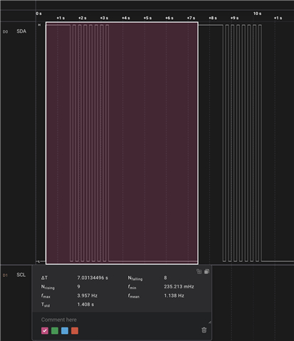

    As per the code, if you check further down in the same function that you copied code from, it will disable the pwm module, and use nrf_gpio to set it to a high or low level, based on if you input 100% or 0 % duty cycle.
    Here is a quick test, based on zephyr/samples/basic/blink_pwm:

    Which behaves like this:
    Håkon

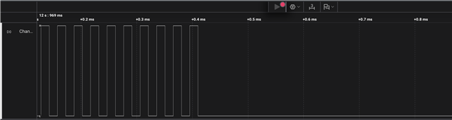

    I'm having a similar issue on an nRF54LM20 although the issue seems more driver related than hardware related. It seems to be an interaction with CONFIG_PM_DEVICE_RUNTIME. When enabled, as soon as the pwm api call is finished, the pm subsystem puts the pinctrl node to sleep. This only seems to happen when i set the duty cycle to 100% and it happens whether or not  zephyr,pm-device-runtime-auto is on the pwm node.

    console:
    uart:~$ pwm usec pwm@d2000 0 30 15 # duty to 50%
    uart:~$ pwm usec pwm@d2000 0 30 30 # duty to 100%
    logic analyzer:
    I am not sure I fully understand the scenario. Your picture shows that the pin goes low after you set it to 100% DC, which is expected per your device tree settings. Trace output shows 50%, then 100%.
    The pin has the "nordic,invert", which will set the active state low:
    https://github.com/nrfconnect/sdk-zephyr/blob/main/dts/bindings/pinctrl/nordic%2Cnrf-pinctrl.yaml#L118-L122
    Could you please create a dedicated ticket for the matter? Please feel free to share more details, especially if this is related to PM_DEVICE_RUNTIME.
    Håkon
  • My understanding was that nordic,invert is used on all ncs pwm pinctrl samples because the peripheral is active low by default. nordic,invert makes these pins active high which is more intuitive. If I do `pwm usec pwm@d2000 0 30 0 # duty to 0%` then the pin still goes low. When PM_DEVICE_RUNTIME is disabled and i set the duty cycle to 100 the pin goes high as expected.
