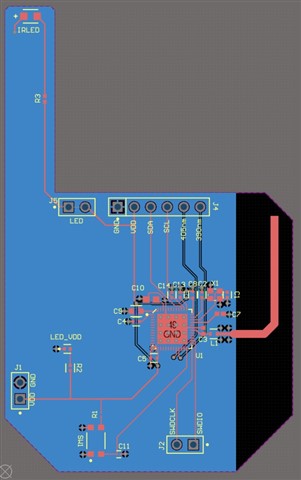

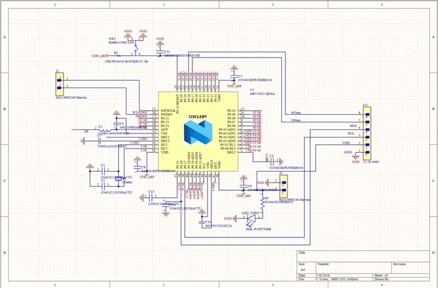

I've recently received a custom board I've designed and am programming with the nRF52DK, following the procedure in L3 E1 of the SDK intermediate course. I've flashed the Zephyr Beacon example successfully to the board and have tried analysing with the nRF connect app on my phone. I'm unable to see my device with the phone but can see when using the development kit. I've uploaded screenshots of the schematic and design, along with the terminal output from visual studio.

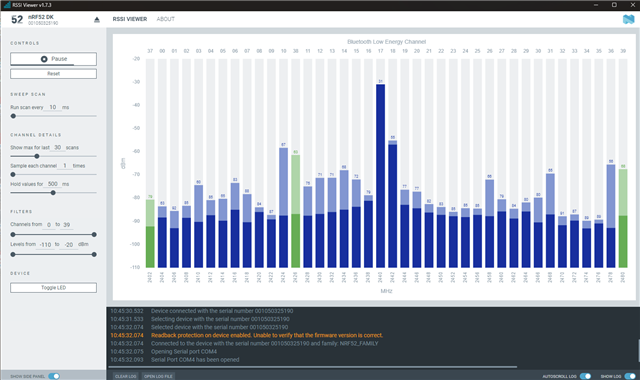

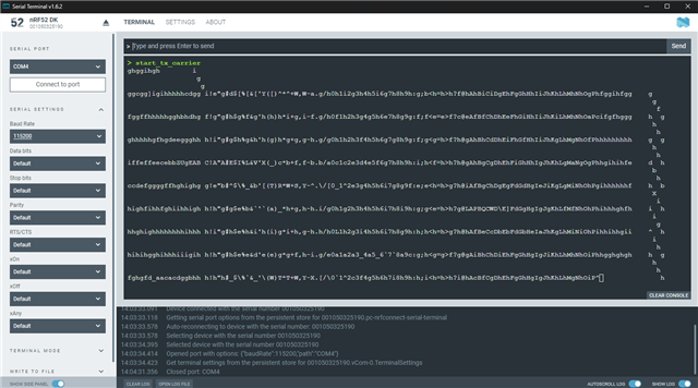

    You could use the radio test sample to set the custom board up with single chennal TX unmodulated at max power to make it simple, but you also use a normal sample like the one u have but know that the singal will jump from channels when advertising.
    https://docs.nordicsemi.com/bundle/ncs-latest/page/nrf/samples/peripheral/radio_test/README.html#testing
    https://docs.nordicsemi.com/bundle/nrf-connect-rssi-viewer/page/index.html#rssi-viewer-app

    Something that can be an issue is that the load cap values for the crystal is not correct, offsetting the RF signal so much that the phone can not "see" the custom board.
    Do you have the datasheet of the 32MHz crystal ?

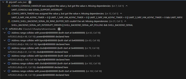

  • I've tried using the radio_test example. It uploaded but I received the following errors and still cannot see my board on the nrf connect app.
    I've also added the following the dts to ensure the dcdc is not used. Will this be ok?
    &reg {
        regulator-initial-mode = <NRF5X_REG_MODE_LDO>;

  • Hi Jonathon,
    I've tried running the Radio_Test on the board. I'm unable to see it with the RSSI viewer app on the nrf52dk.
    When I input the commands on the serial terminal, I get the following response from the custom board, and any other inputs receives the same response.
    I've set the board rate to 115200 in the dts and tired with different rates but am not getting anything legible.
    &uart0 {
    	status = "okay";
    	current-speed = <115200>;
    	pinctrl-0 = <&uart0_default>;
    	pinctrl-1 = <&uart0_sleep>;
    Best,
    John
  • Thanks Jonathon,
    The hex file seems to work. I'm now getting a steady peak on channel 17, smaller peak on 18.
      - with Custom Board powered
      - without Custom Board
  • This is a good result, now we know that there is life in the radio and antenna at least, you are getting a OK amount of power here it seems as well so if the rest is ok then it should work ok.
    I suspect that there might be a issue with the crystal load caps. If the crystal accuracy is to far off then its difficult for the devices to talk, it results in a issue where the devices do not operate on the same freq, so that is likely why it does not show up on your phone. You could try with another phone or PC, to see if they are able to connect.
    But best way to check is to use a spectrum analyzer, the RSSI viewer app is not good enough to check the accuracy to determine the offset exactly. You would need spectrum analyzer to get the exact value to see how far off it is.
    You can try to change the two load caps, go a few pF up or down so see if that improves/solves the situation.
    We can also have a look at the prefromance if you are willing to send a unit to us. we will check the radio and antenna and give you a report.
    Jonathan
