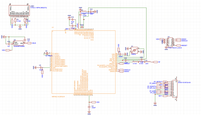

Can you review my RF curcuit? Will it work?
This is my first time designing rf curcuit.
I refered to reference curcuit on datasheet
    Looks like there are still a few connections missing on the layout side like the 32MHz crystal. Its best to copy the reference design if possible, then it will just work, and you seem to have the space for it.
    For the nRF54L series you need 4 layers and make sure the first innner layer is no more then 100um from the top.
    Its a good start but a few things are missing, like you do not actually have a antenna, so that needs to be added if you want to have any rage, maybe you would get 1 cm range with the current setup.

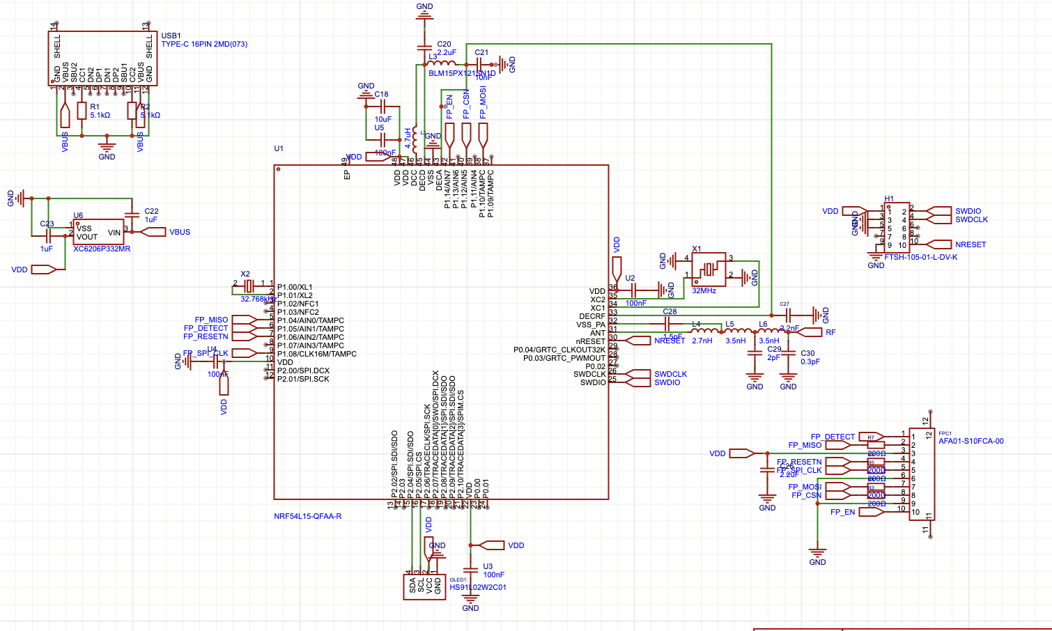

    Here are some links that I think are good that you can go through and once you have done that you can update here with the changes and I will go over everything to make sure it is ok.

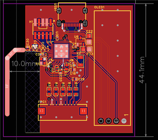

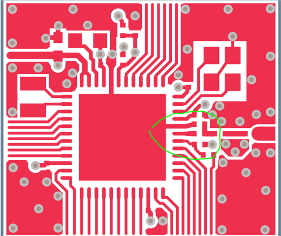

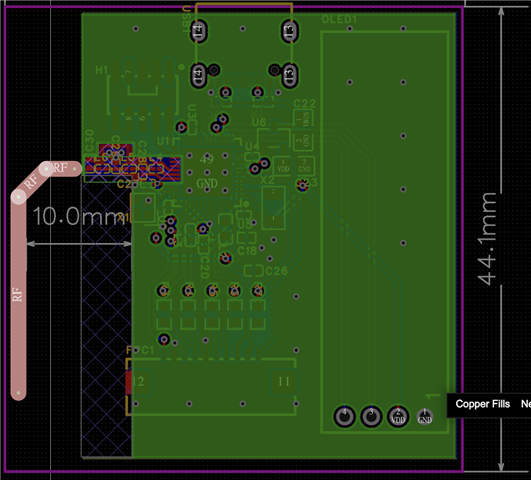

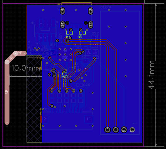

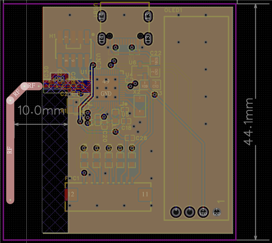

    RF line is 25mm long and has 1.5mm Width with spacing 10mm from gnd plane!
    is it good??

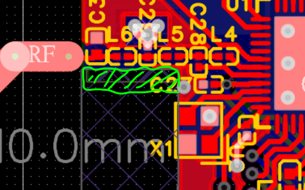

    This is looks a lot better, but a few pointers still:
    The implementation of the antenna here looks ok, its always possible to add some extra length to the antenna and cut the length down for tuning of the antenna for a better match.
    I would add more via connections all over the PCB to tie the different GND layers together.
    See: https://www.altium.com/documentation/altium-designer/pcb/via-stitching-via-shielding#via_style as an example on how to implement via stitching and fencing.
    For the transmission line here I would like to see a full co-planar wave guide, so ground on both sides, so marked in green here on the other side
    I still think there is room to copy the ref design layout exactly, this will make things easier and the likelihood of unwanted performance loss or issues.
    Having the radio matching component close to the nRF54L15 should be prioritized.
