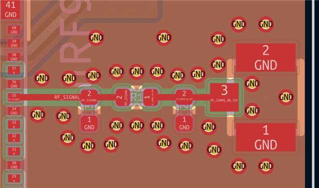

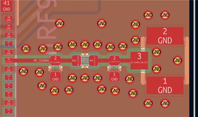

  1. Regarding the LTE antenna, currently we use a passive LTE antenna by The Antenna Company, which is located off-board, attached to the IoT device's enclosure interior and connects to the PCB via a few cm long U.FL connector. With the old modem we're using only one Pi network for matching (we'll be using the TAC matching service), with the nRF PCB design so far, this essentially constitutes almost the entire RF trace length from the nRF pin to the U.FL connector using 0402 components, so it's a short trace about 7 mm (50 ohm). I see this isn't quite the configuration on the non-SMA DK schematic which has two Pi's, do you think it will be enough in our application to include just the one Pi-network for matching the external antenna?
  2. Concerning this point on the ANT pin's documentation: "Avoid excessive capacitance in routing by opening ground layers under component pads. For example, if the routing is on the top PCB layer, open the ground plane under the ANT pad on the next metal layer." So our stackup is JLC's 7628 FR4, with 4 layers and 1.6 mm board, the RF on top and reference on the layer 2 ground plane for coplanar single-ended. Do I understand correctly that for this setup, this would refer to a copper exclusion area in the layer 2 copper plane under the nRF ANT pin and the connector's pad, even though it is the reference? Would layers 3 and 4 be included in this exclusion also? I noticed the DK appears to use layer 3 as the reference and leaves layer 2 open, which isn't our case. And if this suggestion applies to our case, would it be more optimal to extend the exclusion a bit larger than the pad area, or stick to strictly the pad area?

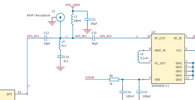

  3. We'll be integrating the nRF's GNSS capabilities into the device as well, our current GNSS antenna is passive, with similar mounting and connection as the cellular antenna, so a front-end module is necessary, we'll be using the SKY65943-11 from the non-SMA DK. I see that the DK includes a bias network with L3, C11, C12 and C13, however I've also found a different reference design and answer here in the Devzone that this is for using an active antenna. However, the non-SMA DK schematic still includes this together with the front-end, even though the Taoglas antenna included seems to be passive. Can you confirm that for a passive external GNSS antenna and using the SKY, we could omit this bias network and connect RF_OUT straight to the nRF GNSS IN?
    External antennas usually don't need a matching network,  as the connector and coaxial cable are both already 50 Ohm. This combined with the nRF9151 not needing a matching network for the ANT pin means that the connector can be connected directly to the ANT pin with a transmission line.
    Just a note on the connector footprint, most ufl connector need a GND keepout between the GND pads. This is due to a metal strip on the underside of the connector, connecting the center pin to the pad. If there is a GND fill on the top layer in this area the RF signal will have a high coupling to GND causing loss of RF power. I recommend you check if this is required for the connector you're using in the datasheet or with the manufacturer.
    Most 4 layer boards have a very thin pre-preg between the outer layers and the inner layers. This means the capacitive coupling between the outer and closest inner layer is very high, resulting in a very narrow transmission line, to keep the impedance at 50Ohm. We recommend using a layer past the center core of the PCB as the reference GND layer for the transmission line to reduce the capacitive coupling between the transmission line and GND. This means either layer 3 or 4 should be used, all layers between the reference GND and the transmission line should have a GND keepout under the trace and pads. If layer 3 is used for the GND reference only layer 2 needs the cutout. This allows for routing traces under the transmission line on layer 4, without affecting the trace impedance.
    On the regular nRF9151DK the bias network is only feeding the J2 connector, to allow the use of external active antennas with the nRF9151 DK connected to J2. Since you're using onboard antenna, you can just connect the output of the LNA directly to the GPS pin.
