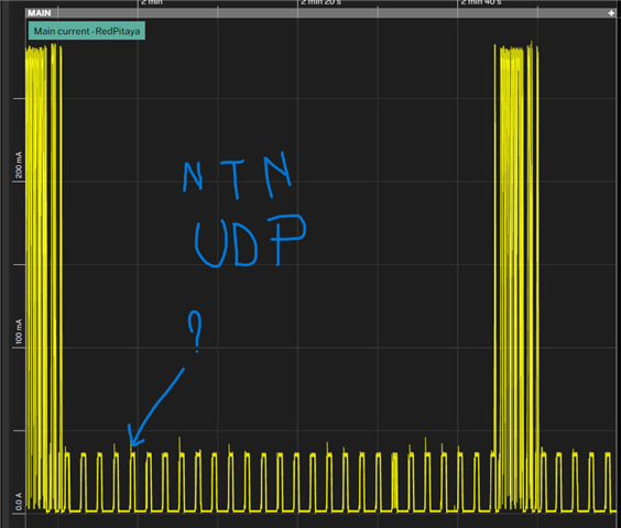

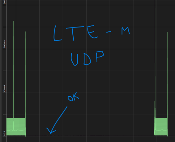

Hi everyone,
I am currently working with Circuit Dojo nRF9151 using nRF Connect SDK v3.0.1.
When measuring power consumption over MQTT and UDP, i noticed ~25mA every ~1.4s when using NTN, what is not the case on LTE-M. Someone knows how to reduce or eliminate it ?
Setup :
Firmware : mfw_nrf9151-ntn_1.0.0-1.alpha
PSM/eDRX : enabled
Protocols : MQTT & UDP
Crucially, it disappears immediately once the socket is closed
Questions:
  1. Is this 1.4s cycle a mandatory requirement for NTN synchronization to handle Doppler/latency?
  2. Is there a way to trigger a faster RRC Release without manually closing the socket every time (already used RAI)?
  3. Has anyone managed to get a "clean" RRC-Idle state (no spikes) while keeping a TCP/UDP socket dormant in NTN?

  • Hello, are you able to provide more information on the steps that you are using? What application are you running?
    Hello, I'm using MQTT & UDP samples
    Setup & Config:
    • Hardware: Circuit Dojo nRF9151
    • Modem FW: mfw_nrf9151-ntn_1.0.0-1.alpha
    • Network: Band 256
    • PSM: Enabled (RAT="00000000", T3412="00101000")
    • eDRX: Requested, but %XMONITOR shows network-provided value 11100000.
    • RAI: CONFIG_LTE_RAI_MODULE=y enabled.
    • MQTT: Keep-alive disabled, clean session.
    • SIM : Terrestar
    • Constellation : GEO
      Response : %XMONITOR: 5,"","","90198","0FA6",14,256,"00093766",6,229366,10,20,"","00000000","00101000","11100000",10
    What SIM are you running in order to connect with an NTN constellation, GEO or LEO?
    I use Terrestar over GEO
