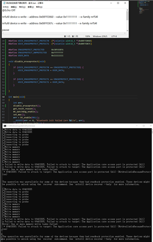

   I have performed the following operations:
    @Echo Off
nrfutil.exe device recover --traits jlink --x-family nrf54l
nrfutil device x-write --address 0x00FFD060 --value 0x50fa50fa  --x-family nrf54l
nrfutil device x-write --address 0x00FFD07c --value 0x50fa50fa --x-family nrf54l
nrfutil.exe device x-provision-keys --key-file keyfile.json --traits jlink --x-family nrf54l
nrfutil.exe device program --options chip_erase_mode=ERASE_RANGES_TOUCHED_BY_FIRMWARE --traits jlink --x-family nrf54l  --firmware merge.hex
nrfutil.exe device fw-verify --firmware merge.hex
nrfutil.exe device protection-set ALL
nrfutil.exe device reset --reset-kind RESET_PIN
So how can I unlock it through my code? My code has an upgrade function.

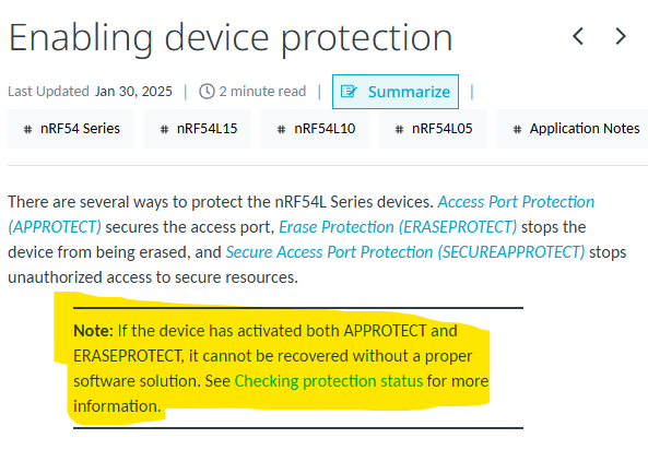

    If both APPROTECT and ERASEPROTECT are activated simultaneously, the device cannot be recovered unless it already contains compatible firmware that supports the unlock procedure.
    Please refer to the note under the Enabling Device Protection section. If the currently locked device does not already include this firmware path, it cannot be added afterward through normal debug access, as APPROTECT blocks debug access and ERASEPROTECT prevents erase operations.
    To enable recovery, the application firmware must write a chosen non-zero key value to the device’s ERASEPROTECT disable register. At the same time, the debug tool must write the exact same key value to the corresponding register on the debug side. Once both sides have written the same key, the tool can perform an erase (recover) operation to unlock the device.

    I understand your confusion, and what you said is correct, debug access is denied when APPROTECT is enabled. However, you can still access the device via CTRL-AP. Please refer to the script I shared in my first response. It is a J-Link script, so you need to use J-Link Commander here, not nrfutil.
    Kind Regards,
    Abhijith
