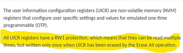

    Август said:
    Do you have any other solutions or methods to write these UICR registers?
    Once the value is written, you need to perform an eraseall to overwrite the UICR. However, with ERASEPROTECT enabled, eraseall cannot be performed
    See the section UICR. I don’t think there is an alternative for this. This behavior is likely intentional, as it is designed as a security measure for final production.
    Kind Regards,
    Abhijith
  • Hi Abhijith,
    Thank you for the clarification.
    This requirement comes directly from our customer, and we’re just trying to verify the production flow. To test the behavior, we took one board and enabled ERASEPROTECT and APPROTECT as per the specification.
    The result confirms what you mentioned: once these protections are set, we can no longer perform eraseall to modify the UICR registers. Therefore, firmware updates will only be possible via application-level updates (OTA/DFU) after this step.
    This is a good confirmation for our production process.
