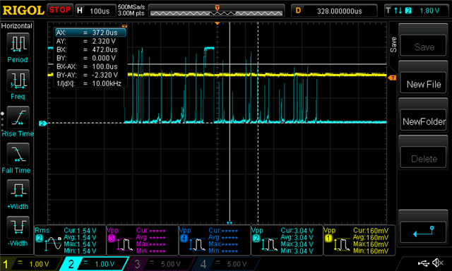

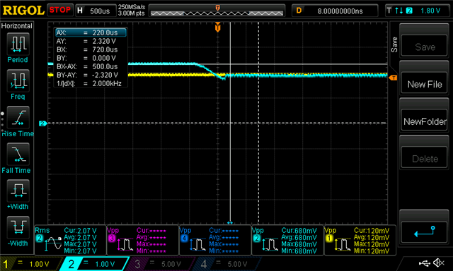

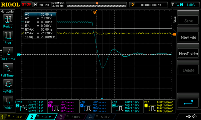

    Additional measurements on the debugger
    Test 3.1
    The RESET signal on the DK was monitored while connecting the SWD cable.
    Result: RESET transitions from approximately 3 V to 1.8 V, with an intermediate point of 2V3, depending on how the connector mates mechanically. Temporary overshoots approaching 3 V can occasionally be observed on the DK side. I couldn't measure in the target side due to the physical placement of the connector.
    However, these events are not reflected on the target VDD or SWD signals. Picture bellow shows the transition between the 2V3 midpoint to 1V8 of the target.

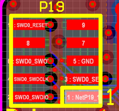

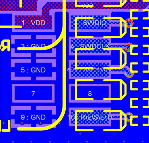

    For reference, the DK's connector:
    And ours:
