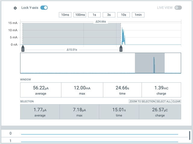

    I setup a test project in zephyr (first 4 blocks on, system on idle):
    system_on_idle_test_nrf54l15.zip
    Where I tried to replicate the setup that you have. Sorry for the magic numbers on the register level.

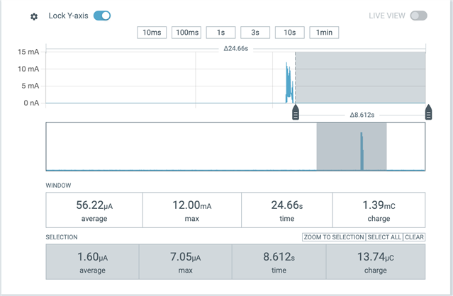

    Testing on nRF54L15-DK, with "almost everything" disabled in the board controller application, and 3.0V:
    I measure a difference of approx. 0.2 uA if I start the LFXO + setup the GRTC as you initially mention.
    No LFXO: 1.6 uA
    LXFO + RTC: 1.77 uA

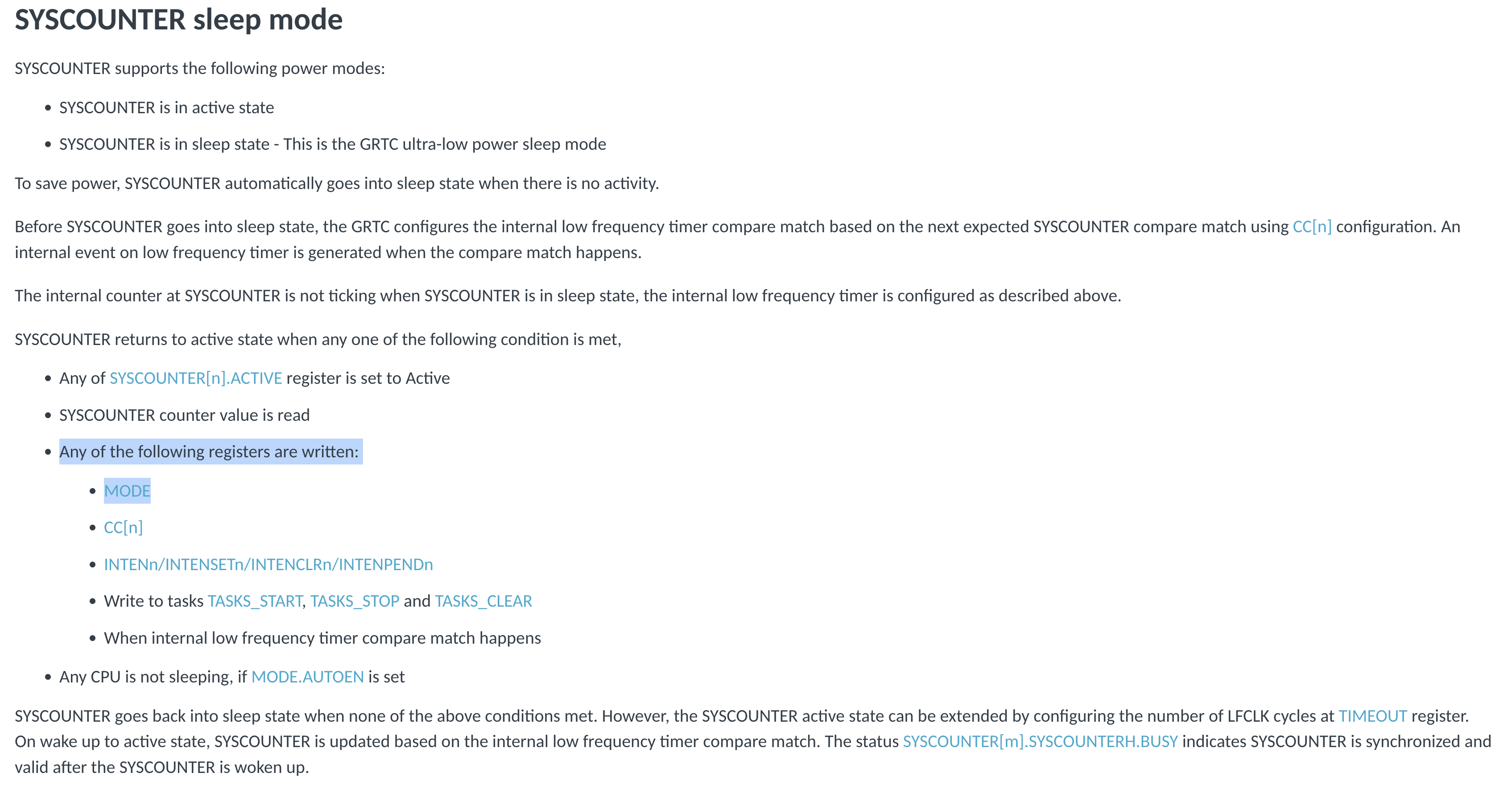

    As there is a write to the registers mentioned in the docs, the LFXO/GRTC will be kept on, accounting for the added ~0.2 uA:
    If you are unsure of the difference between the SoftDevice setup vs. the bare-metal approach, and you think it is related to the clock configuration, you could use Segger Ozone to enter debug mode and look at the register content in both projects, to see if there is anything directly different between the two setups.

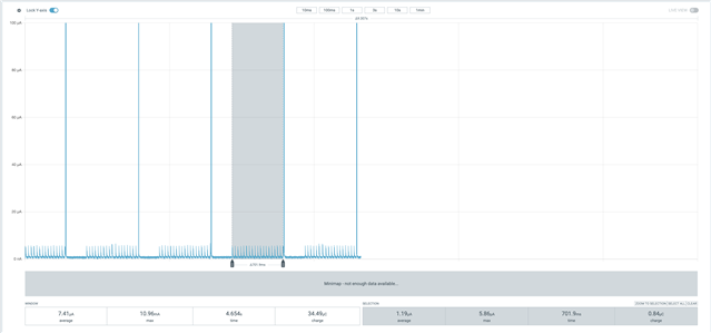

    Thank you for attaching the test fw. I am measuring 1.2 uA "between the events" on this firmware:
    I locked the scale here, to show where the ULP (ultra low power) regulator starts "taking over". Measurements before this period is relying on stored energy on the external caps from the previous active power mode, so will be lower than 1.2 uA until it switches fully over to ULP mode.
    Setting the same retention configuration in NRF_MEMCONF as my former example gives the same, ie. 1.7 uA, as I previously measured.
