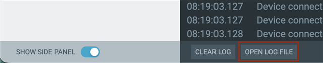

    If it does not work, can you open the full log file and upload it (or copy the content) here? To open the full file, click this button in the bottom of the window:

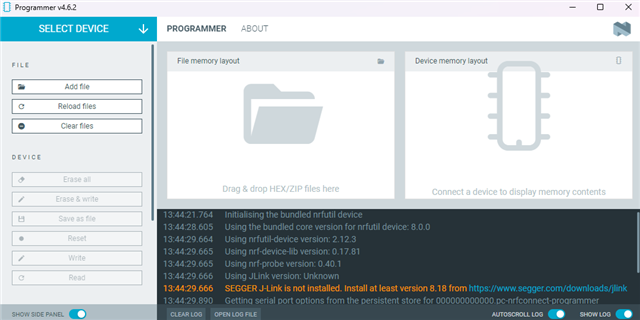

    Below is the log from using the programmer v4.6.2 with Segger v8.18:
    2026-04-09T06:43:35.534Z INFO Initialising the bundled nrfutil device
    2026-04-09T06:43:35.588Z DEBUG Application data folder: D:\Users\erinchen\AppData\Roaming\nrfconnect\pc-nrfconnect-programmer
    2026-04-09T06:43:35.622Z DEBUG App pc-nrfconnect-programmer v4.6.2 (official)
    2026-04-09T06:43:35.622Z DEBUG App path: D:\Users\erinchen\.nrfconnect-apps\node_modules\pc-nrfconnect-programmer
    2026-04-09T06:43:35.622Z DEBUG nRFConnect 5.2.1, required by the app is (>=5.2.0)
    2026-04-09T06:43:35.622Z DEBUG nRFConnect path: D:\Users\erinchen\AppData\Local\Programs\nrfconnect\resources\app.asar
    2026-04-09T06:43:35.622Z DEBUG HomeDir: D:\Users\erinchen
    2026-04-09T06:43:35.622Z DEBUG TmpDir: D:\Users\erinchen\AppData\Local\Temp
    2026-04-09T06:43:36.891Z INFO Using the bundled core version for nrfutil device: 8.0.0
    2026-04-09T06:43:37.133Z INFO Using nrfutil-device version: 2.12.3
    2026-04-09T06:43:37.133Z INFO Using nrf-device-lib version: 0.17.81
    2026-04-09T06:43:37.133Z INFO Using nrf-probe version: 0.40.1
    2026-04-09T06:43:37.133Z INFO Using JLink version: Unknown
    2026-04-09T06:43:37.133Z WARN SEGGER J-Link is not installed. Install at least version 8.18 from www.segger.com/.../jlink
    2026-04-09T06:43:37.210Z INFO Getting serial port options from the persistent store for 000000000000.pc-nrfconnect-programmer
    2026-04-09T06:43:37.215Z INFO Getting serial port options from the persistent store for 001050241194.pc-nrfconnect-programmer
    2026-04-09T06:43:37.220Z INFO Device connected with the serial number 000000000000
    2026-04-09T06:43:37.224Z INFO Device connected with the serial number 001050241194

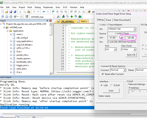

    J-LINK V8.18 can flash the nRF52840 firmware in Keil, but it doesn't work in Programmer.

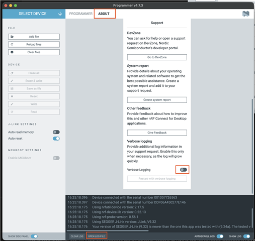

    Edit: Can you also test with verbose logging enabled in the Programmer app and upload the log file here? (Also, if you can do with the latest version again instead of the old that would be good). Enable verbose logging like this:
