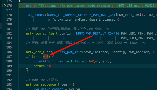

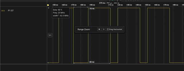

    I built and ran your sample with SDK v3.2.4 and it seems to work fine here:
    The only change I made was to update the error check here to check for 0 instead NRFX_SUCCESS as the nrfx has been updated to use the posix error codes in this SDK release.

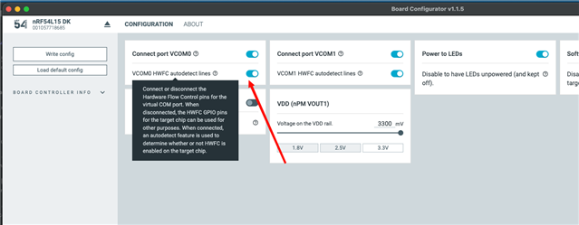

    Also, if you are testing on the nrf54l DK, please note that P1.07 and P1.06 are both routed to interface MCU by default. You can change this through the board configurator app:
