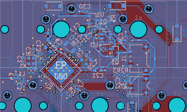

Hi, I just want to double check that I've not made any disastrous mistakes when making this keyboard. I've before used micro controller boards when designing, like nice nano, so this is my first time using the nrf52840 (aWFN73) by itself.

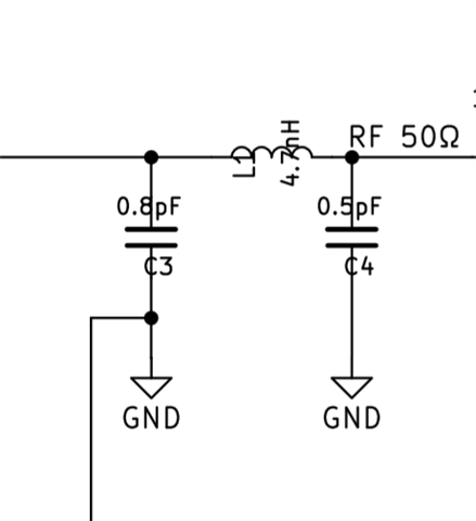

I've tried to follow the NRF 52840 QIAA 1_3 config 3 reference schematic as closely as I could.

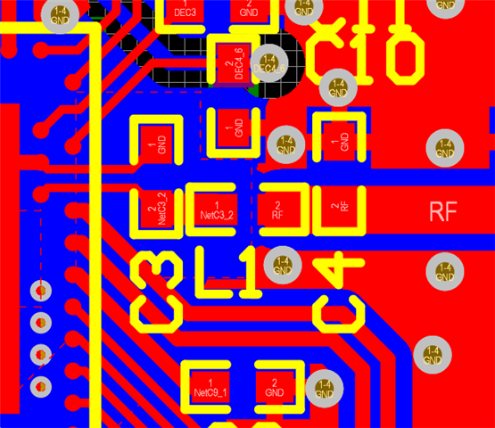

I'm only doing 2 layers, other than being tricky to wire, do you think it will affect the Bluetooth or anything? I also had to short the AD12-P0.17 with the RESET button because I did not have space to trace between the pads. I guess I could do a In pad VIa, but this is fine right?
I'm using JLCPCBA BTW.
