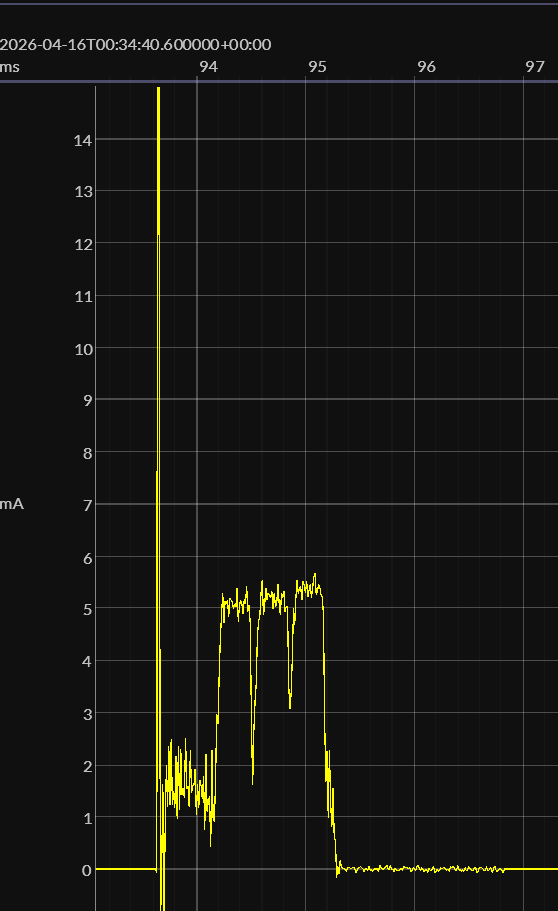

here's what the power profiles looks like when things are working correctly:
the TX current draw of ~5uA is consistent with my expectations (0dB, 3.0V)....  the present implementation actively polls the HFXTAL for it to stabilize, which explains the ~400us of CPU current before transmission begins....   (yes, i know how to make this more efficient....)

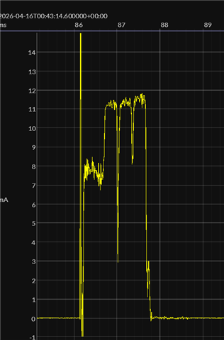

what happens quite often, however, is that my advertising events consume about 5mA *more* current throughout the entire event -- including during the initial period of CPU activity when i awaiting the HFXTAL to stabilize:
same code, same board, same configuration....  this program is *very minimal* (about 2K of code), and configures the HFXTAL and RADIO at the register level....  based on very recent nrf52 and nrf54 experiences, i'm extra careful to ensure HFXTAL and RADIO have in fact flagged an appropriate event after i've triggered a particular task...
still, this seems to suggest some problem on my end with "starting" the HFXTAL and RADIO before transmission...  though not by design, it's as if some other portion of the MCU is (still) powered when i'm waiting for a RADIO interrupt to signal TX on the current channel has finished....

    In a nutshell, you sometimes see a 5 mA increase in the current consumption during the whole radio event, including when the CPU is active polling for HFXO to start. Can you say anything about the difference between when you see it an not? Are there any differences in the state of your application?
    I cannot think of what in the nRF itself would add 5 mA to the consumption, so my gut feeling would be that it could be something external. Do you for instance use GPIO pins to debug, or similar, and could it be that for instance a LED is lit or something else happens during this time?
