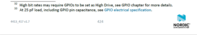

Are there any measurement conditions for the 59ns specification? For example, a wiring capacitance of 100pF?

    My understanding is that the measurement should be done similar to what described at note 33 in the page above.

    I have some initial answer from the team. What you see in the table below of t_SPIM,VMO,HS = 8ns, comes from the SPIM HS peripheral specification (SPIM3)
    The information we got from the team is that 8ns applied for also clock <=8MHz if you use SPIM HS. So in your case it's a good choice to move to SPIM3 (High Speed)
