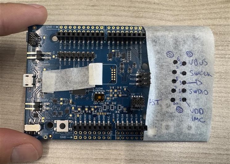

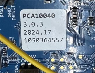

I had some issue with my nRF52 DK PCA10040 v3.0.3, The programmer was totally unreachable also with the simplest terminal command
nrfjprog --recover --coprocessor CP_NETWORK --family NRF53
so I tried to reprogram it trough hidden J13 Tag-Connect TC2050 just under the "PCA10040 v3.0.3" lable.
I was able to flash the programmer firmware trough these commands:

But the Programmer still continue not to show up.
I double checked that everything worked fine, but at the end this thread came out stating that I need production files
(https://devzone.nordicsemi.com/f/nordic-q-a/105606/how-to-burn-j-linkob-firmware-jlink_ob_nrf5340_nordicsemi-bin-on-top-of-nrf5340 )
How can I move forward?
