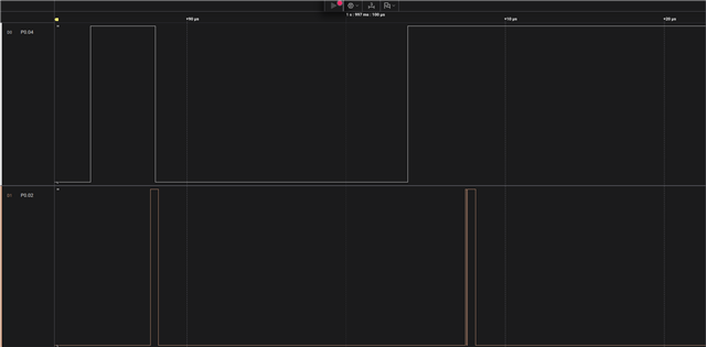

GPIOTE IN event silently drops a rising edge when preceded by a sub-microsecond glitch
Symptoms
A GPIOTE event channel is configured to detect a rising edge on a GPIO input. Via PPI, the event drives a GPIO output low within a few hundred nanoseconds. The setup works correctly in isolation, but intermittently randomly, sometimes several times per second, sometimes seconds apart; the output does not respond when the input transitions. The GPIO input register confirms the pin is high. The GPIOTE channel is correctly configured. The PPI channel is enabled. The CPU can be halted in the debugger and the fault still occurs; it is a pure hardware path failure.
The fault is not in the PPI endpoints, group configuration, channel enable register, or GPIOTE channel assignment. It is in GPIOTE event generation: the peripheral sees the pin transition but does not emit the event signal to the PPI.
Reproduction
The following bare-metal program reproduces the miss on any nRF52805 DK. No softdevice needed; the [155] workaround register is applied explicitly.
Hardware: bridge P0.02 to P0.03 with a wire. Observe P0.02, P0.03, P0.04 on a signal analyzer.

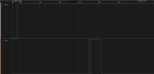

Phase 1 (first 2 s): a single clean 500 ns pulse on P0.02 each cycle. GPIOTE detects every rising edge; P0.04 responds on every cycle.
Phase 2 (after 2 s): a 62.5 ns pre-pulse is added immediately before the main pulse. P0.04 stops responding; GPIOTE misses the main pulse rising edge on every cycle.

What to look for on the analyzer
Phase 1 — working:
P0.02: ___|‾‾‾‾‾|_________________  (500 ns pulse)
P0.03: ___|‾‾‾‾‾|_________________  (same, bridged)
P0.04: ‾‾‾‾|_______|‾‾‾‾‾‾‾‾‾‾‾‾‾  (responds to every edge)
Phase 2 — bug:
P0.02: ____|‾|_|‾‾‾‾‾‾‾|__________  (62.5 ns pre-pulse + 500 ns main pulse)
P0.03: ____|‾|_|‾‾‾‾‾‾‾|__________  (same, bridged)
P0.04: ‾‾‾‾‾‾‾‾‾‾‾‾‾‾‾‾‾‾‾‾‾‾‾‾‾‾  (locked HIGH — main edge missed)
Workaround
Adding hysteresis in hardware so that the pre-pulse does not exist.
