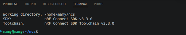

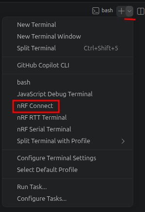

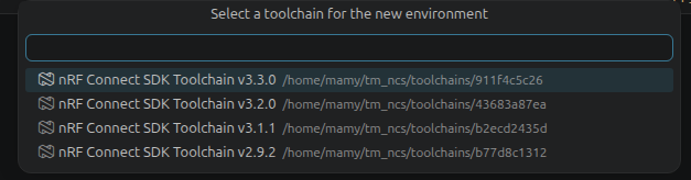

How to run west commands on a VS Code project?
I have a very complex nRF project inside VS Code using the nRF Connect extension(s). Frequently while trying to troubleshoot things I will run across instructions along the lines of "run 'west build ...'" which seem promising but I cannot figure out how to do this in a manner compatible with VS Code.  I've tried entering them into the Powershell terminal VS Code presents and get errors like
usage: west [-h] [-z ZEPHYR_BASE] [-v] [-q] [-V] <command> ...
west: unknown command "build"; do you need to run this inside a workspace?
How do I safely (so as not to screw up the fragile VS Code project) run raw west commands on an existing project?
