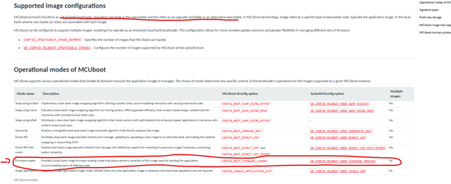

Question: application rollback with multiple slots
Our goal is to increase robustness against failed application updates by supporting a rollback mechanism.
Ideally, we would like to have the following layout managed by MCUboot:
  • Slot 0: firmware_loader
  • Slot 1: running application (active image)
  • Slot 2: download slot for a new application image
With this setup, in case the update of the application fails or the new image is not confirmed, MCUboot should be able to roll back to the previous application image.
From the MCUboot documentation, it seems that this kind of 3-slot configuration (with rollback for the application) is not currently supported out of the box:
https://docs.nordicsemi.com/bundle/ncs-3.2.3/page/nrf/app_dev/bootloaders_dfu/mcuboot_nsib/bootloader_main_config.html#supported_image_configurations
In particular, MCUboot appears to support:
  • single-image or multi-image configurations
  • but not a setup where the application itself has two slots managed independently of the firmware loader.
Here's my questions:
  • Is it currently possible (or planned) to implement application rollback with MCUboot + firmware_loader on nRF54 devices?
  • If not supported, is the recommended approach to integrate the firmware loader into the application image itself (classic MCUboot primary/secondary slots)?
  • Are there any patterns or reference designs recommended by Nordic to safely achieve application rollback when using firmware_loader?

    I think you can use the mcuboot default Swap mode.  The new image is uploaded to the secondary slot, then swapped into the primary slot. The old image is preserved in the secondary slot during the swap, enabling automatic rollback if the new image fails to confirm. See the DevAcademy course MCUboot, and relevant libraries

    Unfortunally the swap mechaninsm is mutually exculsive with firmware loader:
    github.com/.../Kconfig
    That's true. Since the firmware loader mode is a single-application-slot design focused on maximizing application flash space, it trades away the rollback capability in exchange for that larger application footprint. If rollback/revert is a requirement for your design, you would need to use one of the swap-based MCUboot modes instead.
