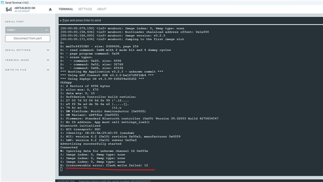

However, in my current tests, the project runs but the SMP server reports the following error every time I attempt to receive new firmware:
Could you please confirm if the current SDK version supports performing external Flash OTA updates using SQSPI?

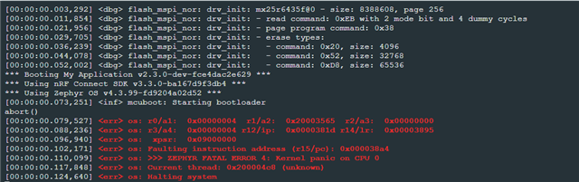

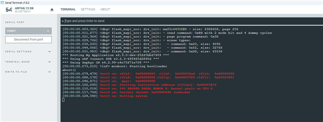

    I have ported my project to the nRF54L15 DK, but I am now encountering a different error.

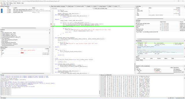

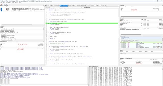

    After debugging, I found that the system hangs at the flash_area_open function within MCUBOOT. An exception occurs specifically when MCUBOOT checks fa_id=1, as shown in the image below.

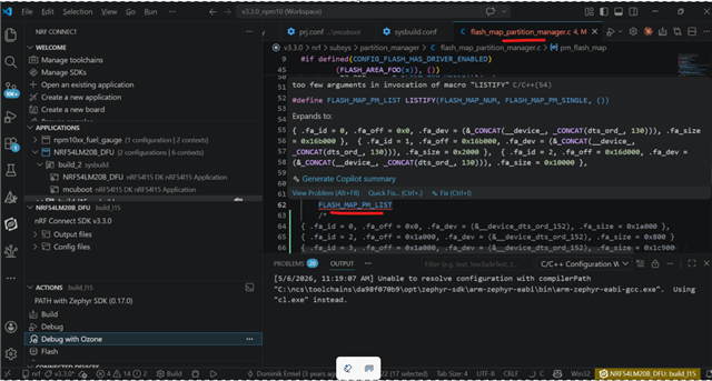

    This issue seems to be related to the FLASH_MAP_PM_LIST shown in the following image.

    I believe you are seeing issue with the new v3.3.0 SDK because the partition manager has been deprecated in that version and MCUBoot and TF-M have been updated to use devicetree partitions instead of the partition manager (Partition Manager deprecation timeline).
    To be sure that it is the problem, can you maybe try to port the application on NCS v3.2.4 to see if you still see the issue?
