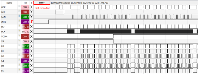

    Unfortunately, I currently only have access to the capture of a pin (BCK) toggled at a fixed delay after the SPI end. This is expected to read ~1us for every transaction when considering the raw transmission time.
    Your mention of the 1us START delay explains the other 1us of delay between the transfers.

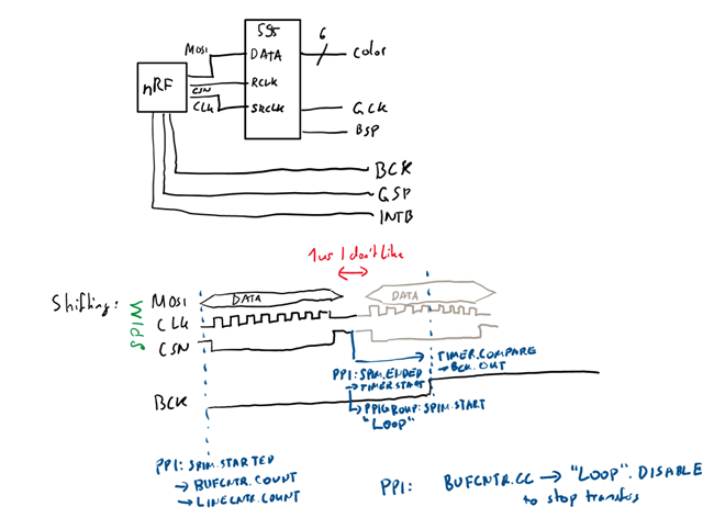

  • Hi
    I think it would be easier if you share a picture of what you're ideally want to implement, and share that.
    I apologize if I was being unclear. I tried to abstract the problem to the smallest possible component, which I realize may have been confusing.
    I'm trying to drive a somewhat complex Display:
    https://www.sharpsecd.com/static/media/LS021B7DD02_Spec_LCP-0620032_201201.5be4ecdb4b72073f1e52.pdf
    To conserve precious pin state, the hardware design uses a 595 shift IC to assert the datalines.
    The sharp datasheet lists very strict timings, but at least a few tested samples seem to be quite lenient and can tolerate a slower clock (at the cost of lower frame rates, which is acceptable).
    I've added a rough overview on how I'm driving the system. A goal is to not have the CPU involved in the transfers, hence I'm using the PPI interface.
    In summary, I'm using the SPIM in DMA.TXLIST mode to emit 1 byte, then assert CSN (which moves from the 595's input register to the output), then start the next transfer using a PPI group.
    At the end of each byte, the SPIM auto-sets CSN, which asserts the input register of the 595 to the outputs. I then use a timer to delay the BCK toggle (which samples the outputs into the display) to roughly the middle of the following transfer. Because of the TXLIST, the DMA pointer is advanced, and the next transfer will transfer the next byte.
    The PPI group is disabled when the counter reaches the specified amount of bytes, therefore disconnecting the loop.
    Essentially, this allows me to transfer a "frame buffer" (which also contains the control signals) from RAM without any CPU intervention. During the special frame start / frame end sequences of the display, I'm currently using an IRQ state machine for now.
    The linking of PPI to actual "byte end" events allows for precise timing of the signals. If I was to transfer thousands of bytes, I'm worried that hard-coding timer values might skew when the DMA delays ever so slightly, and the skew leading to imprecise signals towards the end of the transfer.
    The result is qualitatively correct, but the timings are stretched due to the delay between the SPI transfers. Hence, the question is how I can reduce this delay.
    The stretched clocks on GCK / delays between the blocks of BCK are due to an interrupt which gradually releases chunks of the ring buffer; I'll optimize this later.

    Thank you for sharing a schematic. This is helpful for my understanding of the situation.
    I would recommend setting up a test with TIMER/GPIOTE/PPI controlled CSN pin in this scenario, where you start a timer based on the NRF_SPIMx->EVENTS_STARTED event, and clear/set the GPIOTE IN channel when each byte is finished (based on a set capture/compare value).
    You can potentially think about adding a "dummy byte" in every other byte, if this has a negative impact on the timing requirements of the sequence as a whole.

    This is also my understanding. The question I have is how it's possible to remove this 1us delay after TASKS_START (or hide it by starting the work earlier)
    Removing this start-up delay would effectively be to use DMA to transfer more-than-1-byte, and using application controlled CSN (GPIOTE/PPI/TIMER)
    This will create a delay at the very start of a transaction, lets say of 240 byte, but there will then be no delay between each byte. Depending on the timing requirements of the display, this "no delay between bytes" could potentially be problematic? Example: if the pulse on "CSN" must occur for every byte _and_ must be 125 ns, and the bit width of the upcoming sequence is then 125 ns, this leaves the possibility of a skew/overlap, or am I misunderstanding?
    What I am trying to ask: Can the "CSN" signal overlap with the upcoming byte safely?
    I read this as a potential "show-stopper" for this solution, based on your comment here:
    cwriter said:
    Ideally, there would be just 1 SPI clock cycle (~1/8us) of CSN high, before the next transfer is triggered - or, in absolute times, the hold time of the 595 is 24ns - so CSN high can last essentially arbitrarily short, but it must be (stably) high before the next transfer.
    This indicate that the sequence must be in-order, ie. cannot run in parallel?
    But, that could then be worked around by sending every second byte as a dummy-byte. Your DMA buffer would then be 2*wanted_buffer_size.
    Another option would be to use the NRF_I2S peripheral to bit bang this implementation, as it generates a word sync (left/right).
    Yes, this would be almost perfect! Unfortunately, the I2S does not support a 4-bit transfer window, and the 595 only samples on the rising edge - therefore, this would also include a dummy byte, and the data rate would again be relatively low.
    I did not quite get this, sorry. It can be "parallel" in that there is no need to be able to stall the transfer - but if the transfer is not stalled a little bit, timing the CSN posedge within 1 SPI clock cycle will certainly be hard, especially since it should tolerate SPI clock skew.
    The key issue I have is that I'm afraid of desyncs when not timing the events with the actual clock on the SPI clock line. Essentially, I'm looking for some kind of re-synchronization.
    I was considering the following other options which would link actual SPI bus behavior to events - maybe you could tell me if this could work? (Unfortunately, I fail to get more information about these elements from the documentation - they seem to be underdocumented for the SPIM compared to the TWI and UART counterparts, and the DMA.MATCH is referenced to the EasyDMA section, which does not discuss it at all).
    SPIM SHORT
    Just to be clear: You're confirming that the SPIM.SHORTS[END_START] also suffers from a 1us delay? There was a similar question here for an older revision, which seems to indicate that the delay is present even with the short: NRF5340 SPIM turnaround time
    SPIM RX MATCH event
    If the SPIM MISO line is not connected (no pin configured in the CONFIG register), will the DMA read a defined value (maybe 0)? If so, is it possible to program the DMA.RX.MATCH event to a single 0 byte value which could trigger after every byte, and PPI the CSN toggle? Does this work without setting a DMA read pointer (i.e. with DMA.RX.MAXCNT=0), or is it safe to read into the same buffer that was used to send? Does it match on 4-byte-values only or does it match on single bytes? What is the delay of DMA.RX.MATCH?
    SPIM SUSPEND + RESUME
    Does a SUSPEND task triggered immediately after starting assert CSN when the byte ends? Does RESUME also have the 1us latency or can the SPIM resume immediately? Even if this does not assert the CSN, this could be an option to PPI the CSN, and potentially stretch the SPI clock in order to get more time in between, i.e. START -> SUSPEND (byte still transfers) -> (Transfer ends) -> PPI'd + TIMER'd + GPIOTE'd CSN triggers -> PPI'd RESUME + TIMER.CLEAR for the next byte. Unfortunately, there seems to be no SUSPENDED event - is this correct? - but the timer could be used to work around this.
    In short: Is there any documentation about the SUSPEND mechanism for SPIM available?
    SPIM CLK SNIFFING
    Not possible from what I take from the datasheet, but worth a try: Is it possible to connect the input buffer of the GPIO to a GPIOTE counting rising edges while the SPI peripheral is clocking it? If yes, this could be used to count the rising edges, and simply trigger on every 8th rise.
    SPIM + PPI (assuming no SPI clock/DMA skew at all)
    Just to verify: What values would need to be set? Is the PPI triggering on every rising edge of the PCLK (16 MHz) or is it double-clocked on rising and falling edges (32 MHz)? Would I need to set a delay of 7 cycles due to a 1 cycle PPI delay in the same domain?
    I2S + PPI
    Looking at the I2S peripheral, there is no delay of 1us, and it seems to be possible to clock at the same frequency. Would it be possible to set MAXCNT to 1 and chain the transfers through PPI to achieve a higher throughput than using SPI? Does the I2S peripheral automatically update the TXD pointer internally (given that the description reads: "EVENTS_TXPTRUPD: TDX.PTR register has been copied to internal double-buffers. When the I2S module is started and TX is enabled, this event will be generated for every ceil(RXTXD.MAXCNT/4) words that are sent on the SDOUT pin." it should, trigger on every start when MAXCNT=1 - or did I misread?
    Kind regards
    Just to avoid any misunderstanding here; there is no peripheral/DPPI connection that fully fits your use-case, meaning; there will be side-effects with all proposed solutions.
    To sum up your choices, and its side-effects:
    * SPIM has a start-up delay, reduces throughput
    * DPPI/TIMER/GPIOTE will be problematic to sync towards your byte clock, can be problematic when latching towards the external circuitry.
    * NRF_I2S will require a dummy transaction, where you use the LRCK as "CSN".
