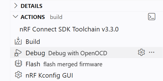

NCS created binds:
    "cortex-debug.liveWatchRefreshRate": 300,
    "cortex-debug.armToolchainPath": "D:/ncs/arm-gnu-toolchain-15/bin",
    "cortex-debug.gdbPath": "D:/ncs/arm-gnu-toolchain-15/bin",
    "cortex-debug.openocdPath": "D:/ncs/openocd/bin",
    "nrf-connect.flashOnDebug": false,
    "nrf-connect.taskBindings": {
        "flash": [
                "taskName": "flash merged firmware",
                "buildConfigs": [
                    "${workspaceFolder}\\build"
    "nrf-connect.debugging.bindings": {
        "${workspaceFolder}/build": "Debug with OpenOCD"
After pressed the "debug"(insert does not work,so, plain text):
* Executing task: nRF Connect: Flash: l1_e2/build/l1_e2
Flashing l1_e2 to B001A000000
west flash -d d:\ncs\myfw\ncsfund\l1_e2\build --domain l1_e2 --no-reset --dev-id B001A000000
-- west flash: rebuilding
[0/5] Performing build step for 'l1_e2'
ninja: no work to do.
[2/5] No install step for 'l1_e2'
[3/5] Completed 'l1_e2'
[4/5] C:\WINDOWS\system32\cmd.exe /C "cd /D D:\ncs\myfw\ncsfund\l1_e2\build\_sysbuild && D:\ncs\toolchains\936afb6332\opt\bin\cmake.exe -E true"
-- west flash: using runner nrfutil
-- runners.nrfutil: Flashing file: D:\ncs\myfw\ncsfund\l1_e2\build\merged.hex
Error: No devices with requested serial number(s) or trait(s) found
FATAL ERROR: command exited with status 1: nrfutil --json device x-execute-batch --batch-path 'D:\ncs\myfw\ncsfund\l1_e2\build\l1_e2\zephyr\generated_nrfutil_batch.json' --serial-number B001A000000
* The terminal process terminated with exit code: 1.
* Terminal will be reused by tasks, press any key to close it.
the launch name has been displayed beside the "debug", the launch.json will displayed if you press the gear button。
It worked once before: the script runs if debug button pressed, though did not success,but now it completely ignore the launch.json.
The base target: debug with CMSIS-DAP .
It will be very helpful to provide guides on configuration.

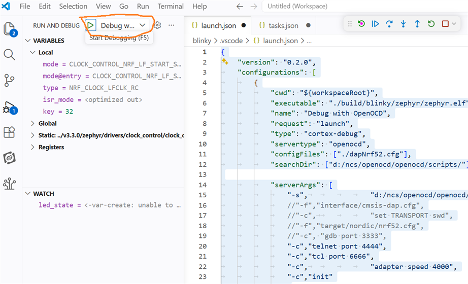

    create launch.json to debug.
    Add configuration -> openOCD(Debug with OpenOCD):
    	"version": "0.2.0",
    	"configurations": [
    			"cwd": "${workspaceRoot}",
    			"executable": "./build/blinky/zephyr/zephyr.elf",
    			"name": "Debug with OpenOCD",
    			"request": "launch",
    			"type": "cortex-debug",
    			"servertype": "openocd",
    			"configFiles": ["./dapNrf52.cfg"],
    			"searchDir": ["d:/ncs/openocd/openocd/scripts/"],
    			"runToEntryPoint": "main",
    			"showDevDebugOutput": "both"
    			"type": "nrf-connect",
    			"name": "Launch blinky/build/blinky",
    			"config": "${workspaceFolder}/build/blinky",
    click debug:
    Waiting for gdb server to start...[2026-05-05T10:27:25.024Z] SERVER CONSOLE DEBUG:
    onBackendConnect: gdb-server session connected. You can switch to "DEBUG CONSOLE"
    to see GDB interactions.

  • update:
    changed :
    "gdbPath": "D:\\ncs\\arm-gnu-toolchain-15\\bin\\"
    to
    "gdbPath": "D:\\ncs\\arm-gnu-toolchain-15\\bin\\arm-none-eabi-gdb"
    now,output:

    You can change your port number if it will not trigger "50000" error.
    7)bind Actions->debug to launch(Debug with OpenOCD,in this example);
    8)clik Actions->debug;
    The nrf connect extention will shift to debug GUI, and it maybe still try to use nrf tool and trigger error,
    Just ignore them,In debug GUI:
    You should select the right option in the drop down menu and then click the arrow button.
    Now you can see the log in debug console and TERMINAL(right bottom of the GUI,default).
