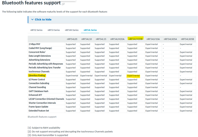

    Whether Bluetooth Direction Finding is supported on nRF54LM20B hardware
    Yes, Bluetooth Direction Finding is supported on the nRF54LM20B, but it is currently at Experimental maturity level.  See https://docs.nordicsemi.com/bundle/ncs-latest/page/nrf/releases_and_maturity/software_maturity.html#bluetooth_features_support
    Please be aware that for the nRF54L Series (including nRF54LM20B), only the AoA (Angle of Arrival) transmitter role is supported. Full AoA/AoD receiver functionality is not indicated as supported.

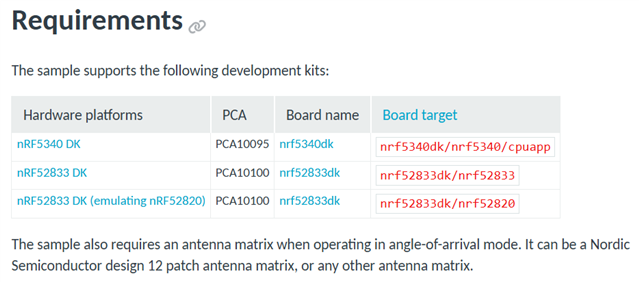

    Any available sample/reference applications (Initiator/Reflector or Locator/Tag) to get started
    See
    The locator/receiver side samples (direction_finding_connectionless_rxdirection_finding_central) doesn't support nRF54L.
    Subhiksha said:
    Additionally, please advise if any external antenna or antenna switching requirements need to be considered for Direction Finding evaluation.
    An antenna matrix is required when operating in Angle of Departure (AoD) mode. Given that only the AoA transmitter role is confirmed for the nRF54L Series, you should primarily target AoA use cases.
